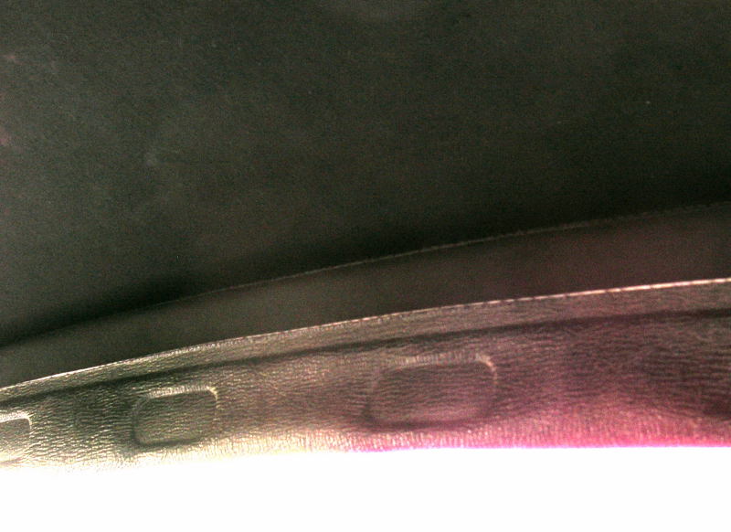

I have my top on (Robbins) and want to know what the front flap does and how it goes on.
Doing all my detail work.
Any help would be appreciated.

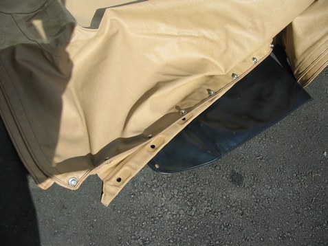

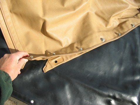

I bought my Robbins top from Roadster Factory in 1989. It came with no instructions but they were very helpful over the phone. I still couldn't visualize what John Swauger was trying to explain to me, even after 3 times. So he mailed me a sketch showing how to do it. He was very helpful. It worked and I have had no issue with it since.
Basically I had to take a hammer and a 1/2" diameter round hole cutter and I had to stamp holes into the depressions you show in your photo. These line up and fit over the hex base of all the pegs along the top of the windscreen. Then you fold it back and push down on the outer cap of the retainer onto the peg.

Thanks Don, will find a 1/2" hole punch and do as you show.
I guess the flap acts like a water seal?
I was letting the flap hang down inside, was like a sun visor.
