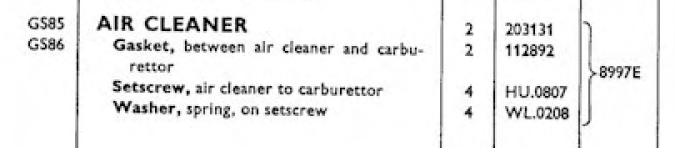

Air cleaner bolts are 5/16NF (24 tpi)

The original factory part numbers for common hardware will give you the relevant details. All common hardware items start with two letters (eg the HU0807 shown above), and can be found in the hardware catalog:
