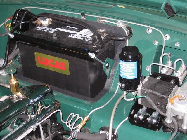

Yes the plate is normally secured using those 2 screw holes. They often corroded through and fell off by the acid spitting out from the battery. When I bought my TR3A (brand new in 1958) the dealer topped up the battery. He told me he did. He put so much water in it that it was up to just below the caps. I later found out that the voltage regulator (control box) had left the factory with a setting that produced 15 volts. This boiled out the battery acid and not only was the lower body number plate eaten through, but it also ate through the steel where the bend above the battery box is located - just below this plate. Since my restoration in 1987 to 1990, I have had no problems with corrosion here because the control box is set properly and I fill my battery to the correct level. And I don't have a plastic box for sitting the battery in like so many sidescreen TR owners have. BTW, TRA judges do not deduct points if you have one of these recent plastic battery boxes. The top flange of this non-original item covers the missing body plate location, so the competitor saves himself a lost point if he does not have this plate, because the judges can't see if it's there or not. I have a friend who used to work on TRs and he had losts of spare parts. He gave me a very nice body plate. It's not the right number, but it saves me losing a judges's point at TRA or VTR.
See the attachment how the recent battery box on this BRG TR3A covers the EB plate.

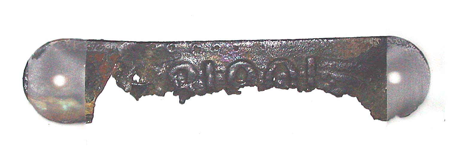

Yes. If you send for the build record, that information will be provided. I posted a request for info regarding these numberplates recently. The lower tag, the one closest to the battery, gets the acid fumes and gets eaten away first. See the attached photo. Only half is left! I received a lead on this ompany:https://www.clarkespares.com/carparts.html
They are located within an hour's drive of me. I will be checking them out this week and I will post the details.

Frank - My original one looks only a little better than yours. If he can make a new one like the originals let me know. I've been looking for 15 years for someone who can make me one with the correct number for me.
