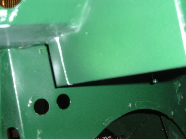

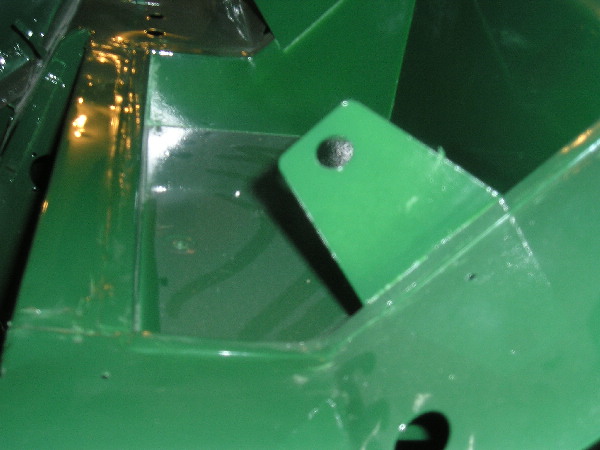

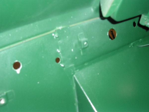

Art, I didn't do the actual replacement, it was done by my budy the body man. As I recall it was basically a cut the old one out and drop the new one in. Kind of like franks. He has some great pictures in his post. I wish I had taken more pictures. I have added 4 pics of how mine came out. Hope this helps some.
Cheers, Tinkerman

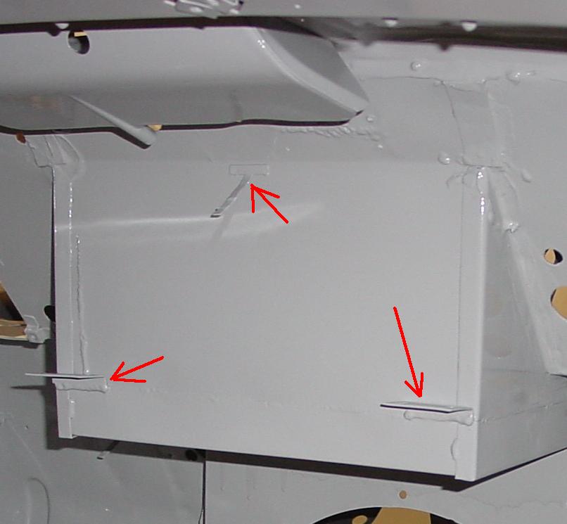

Before this thread gets away, I need to tack on another question:
For the Roadster Factory Box, does it include the mounting tab for the dash bracket, or is that something you need to fabricate separately?
Thanks
Randy
Yes Randy, if your talking about the two tabs on the dash side of the box they are on there. Just can't see them in my picture.
Tinkerman
