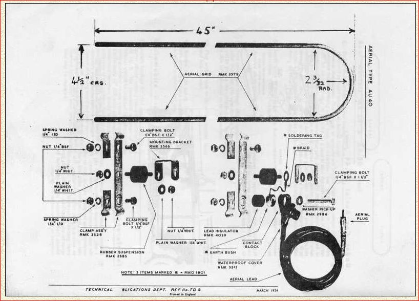

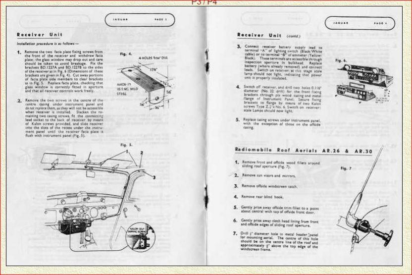

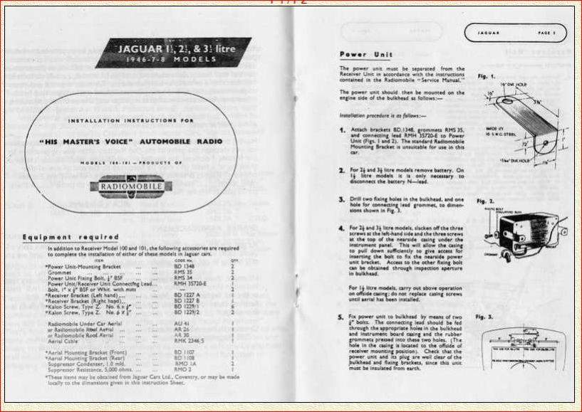

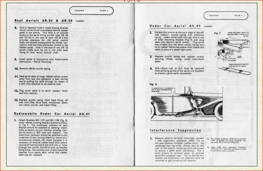

Keith: This is something that I intend to make eventually for my tube-type TR radio. However, the under-car option, would work for any AM band radio, and it's invisible. I will fabricate the loop from aluminum tubing.
