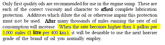

I've always thought this was amusing (from the early TR3 owner's handbook)
