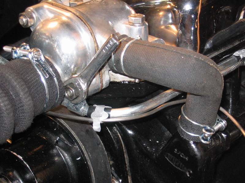

I have had the bypass hose slide off. The place where it should be secured to the side of the thermostat hpusing is tapered on mine. The addition of antifreeze makes it all too slippery and the more I would tighten the hose clamp, it would want to slide down the taper till it leaked. So I filed a deep groove into the aluminium housing all around and this has held now for the past 10 or 12 years.
It it had ever slipped off again, I would take it to my neighbour who can MIG and TIG weld. I would ask him to weld on an aluminium bump all around like you did with the silicone tape.

Yep, I've also had the bypass hose slip -- what I didn't mention above is that I added a 'ring' to that connection too:
Thoughtful of Triumph too make that snout not merely smooth but slightly tapered (perhaps it was easier to get out of the mould that way?).
Yes, a second clamp or a modern band clamp might help but I'm stubborn and want the look (and attendant limitations) of the single wire clamp.
