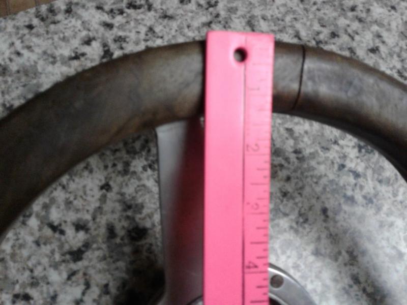

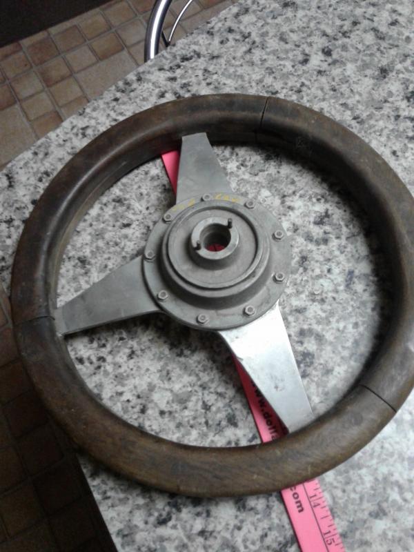

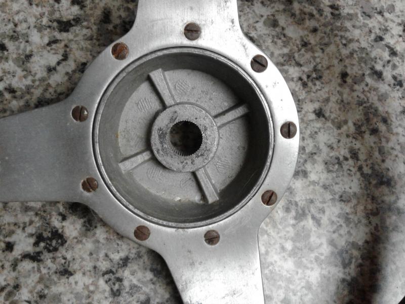

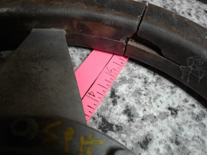

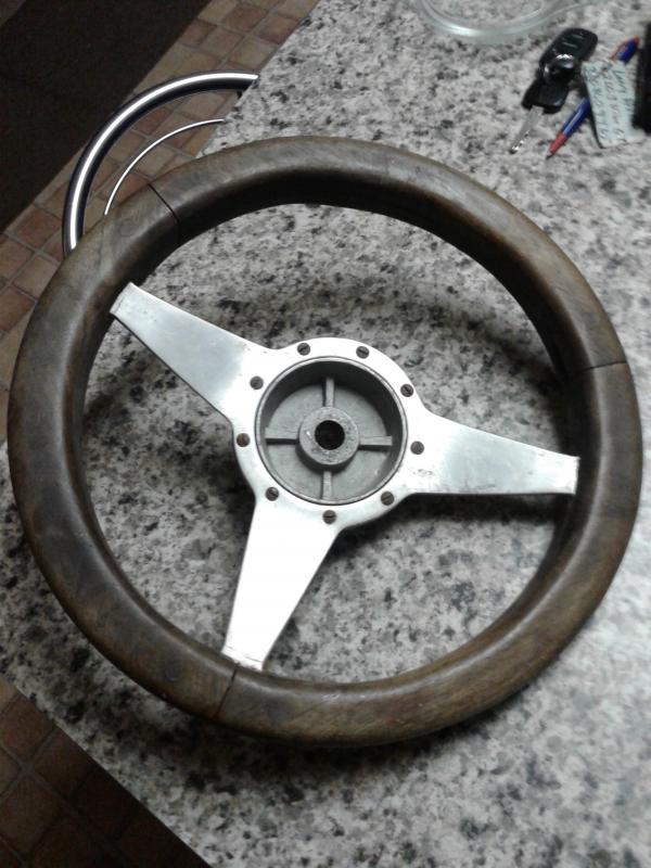

glemon, i have this steering wheel that one of my customers gave to me when he converted his Spitfire from a racing autocross car to a street car. It is 13 1/2". Different. needs some TLC but has a nice wide grip. Was going to put it on Ebay but never got around to doing it. If you or anyone else is interested PM me and we'll work it out.

That is the late wheel 78 to 80, the two prongs are the signal light counsel. Splines are different.
Be a nice one for some to restore, plus it has the hub which is not always available.
Thanks, I wondered about the nubs, I think the earlier stock Spitfire steering wheels are about the same size as the Tr250/6.
