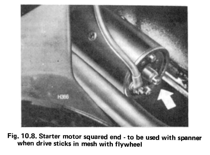

I did take pictures when I took the car apart, but not of this particular place. Does the power post (lead from the solenoid/battery) fit so that it is closer to the block or closer to the outside of the car, looks like I could fit it either way, I am guessing to towards the block, but just wanted to make sure, thanks, Greg
A photo in my Haynes shows it with the terminal away from the engine block.
