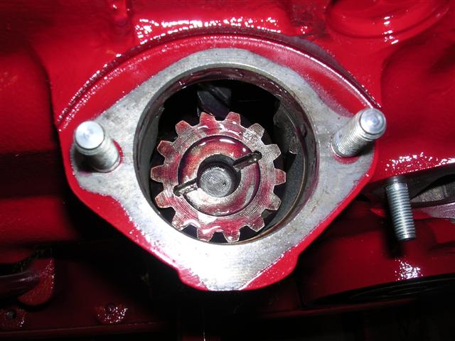

LMHO, over 50 bucks with shipping for a valve cover gasket? Get some 1/4" O ring material, measure length around groove in valve cover, cut O ring, super glue ends together. Long lasting valve cover gasket for less than 5 bucks. Cam bearings? Most likely over a $1000.00 installed, not worth the price. Thrush washers? Nothing wrong with original, unless you have clutch pressure plate problems. Also, that TH5 cam blank mentioned in this thread is made in India. When you install it in the block, look at the dist. gear, is it centered in the opening? NO. Look at the lobe position on the rear 5 lobes. These lobes were moved because the company who has this blank made, and grinds them, did not have the machine necessary to grind the gear with the lobes in the "factory original" position. So, he had the lobes moved. Who knows how this will hold up? But, they can always blame it on the motor oil now can't they? Don't drink the koolade dude.
You are entitled to your opinions and to spend your money your way. That doesn't mean that everyone will agree with you either.
And just for your information, that TH5 cam was ground in England, not India. Every lobe of the cam and the gear lined up perfectly or the machine shop would not have installed them.
Where do you come up with some of this stuff???? I think that you better avoid anymore of your KoolAid, Dude......
And one more thing, please explain to every reader of your rant how my distributor drive gear is NOT centered in this picture. That statement is about as accurate as the rest of the crap that you've posted above. I never knew you were such an expert on an engine build that you never personally saw.
PLEASE NOTE LOCATION AND POSITION OF GEAR IN BLOCK BELOW. THAT LOOKS PRETTY WELL CENTERED TO ME. ANY OTHER INCORRECT COMMENTS TO RANT ABOUT????
