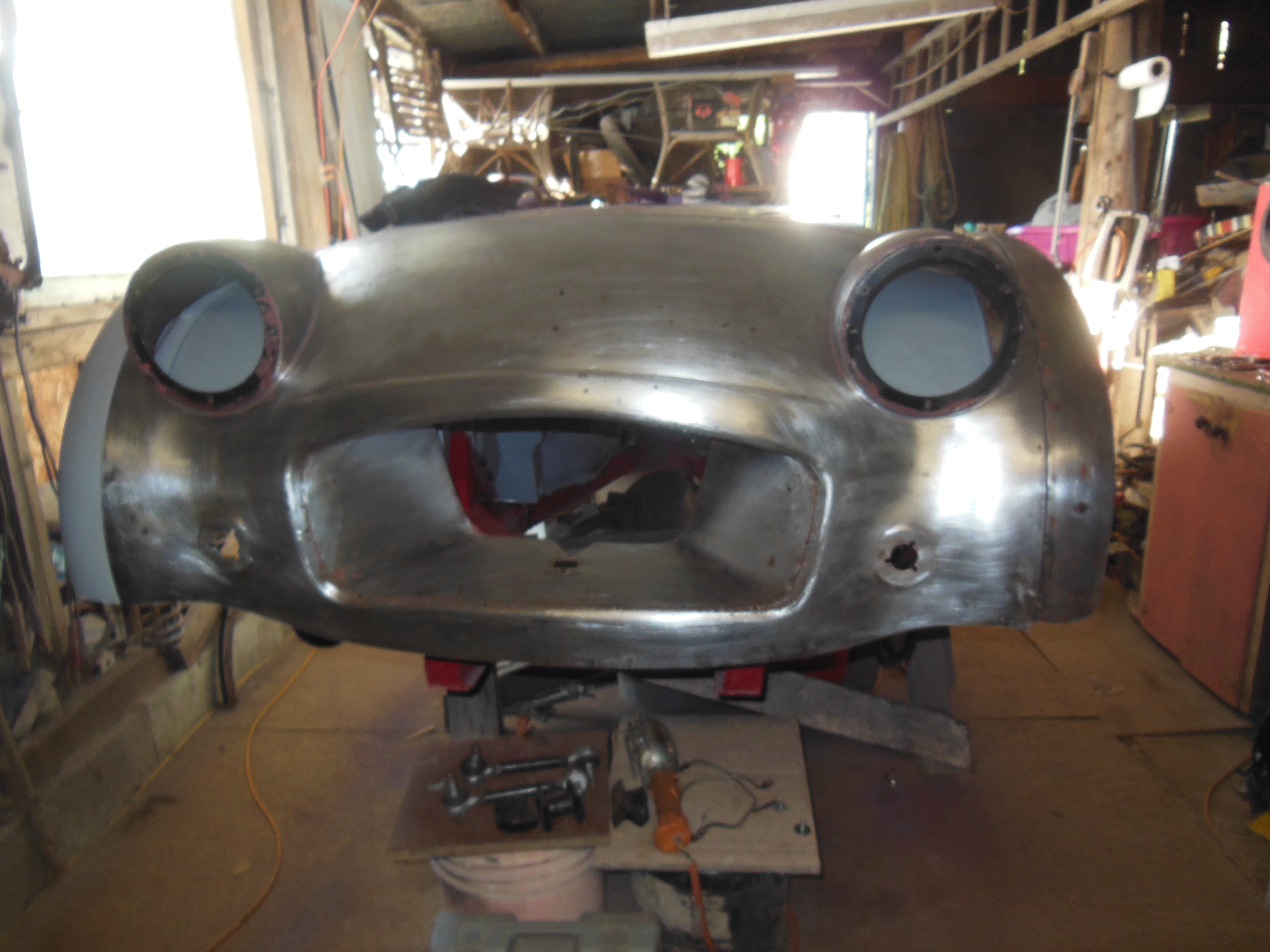

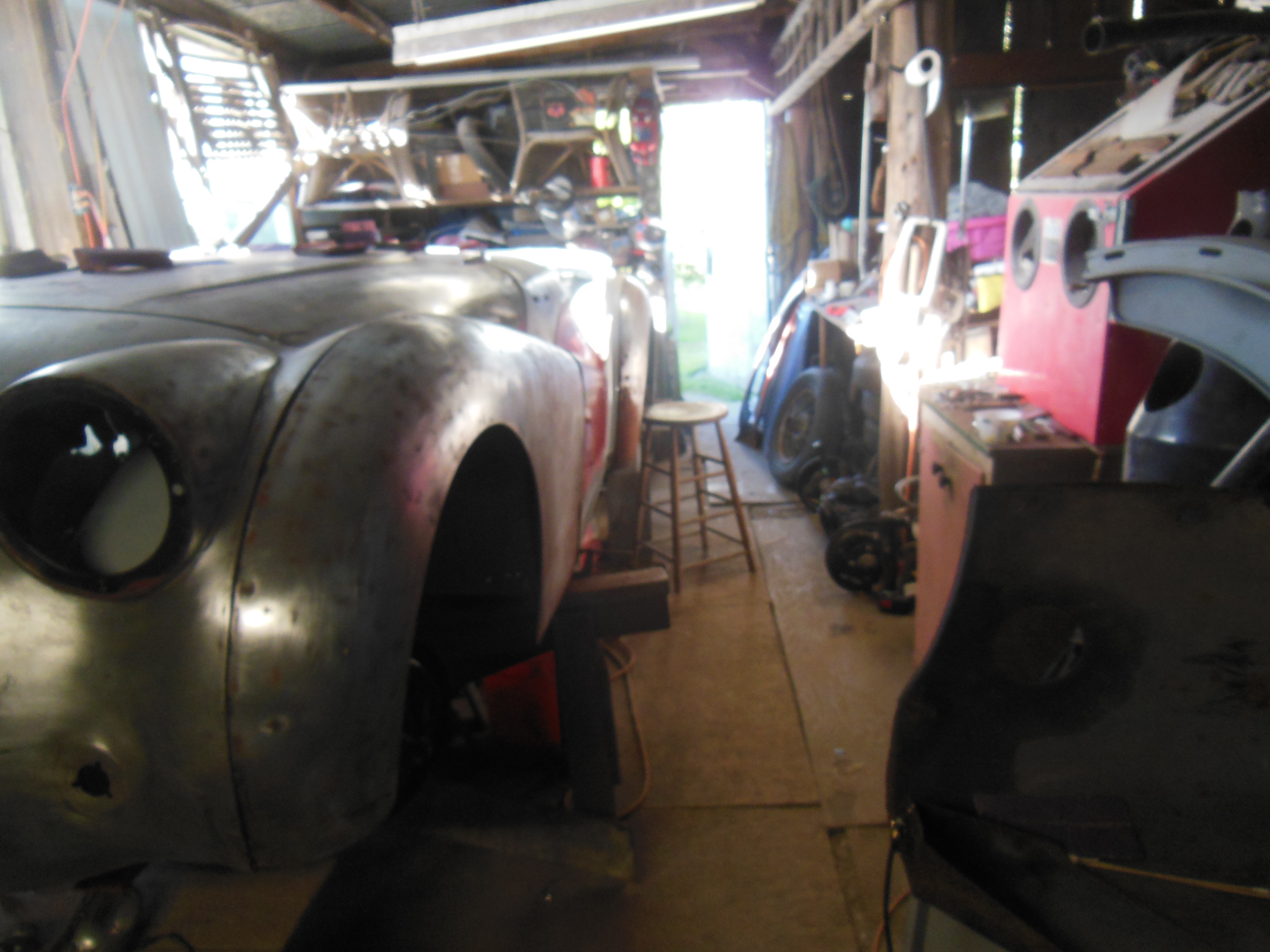

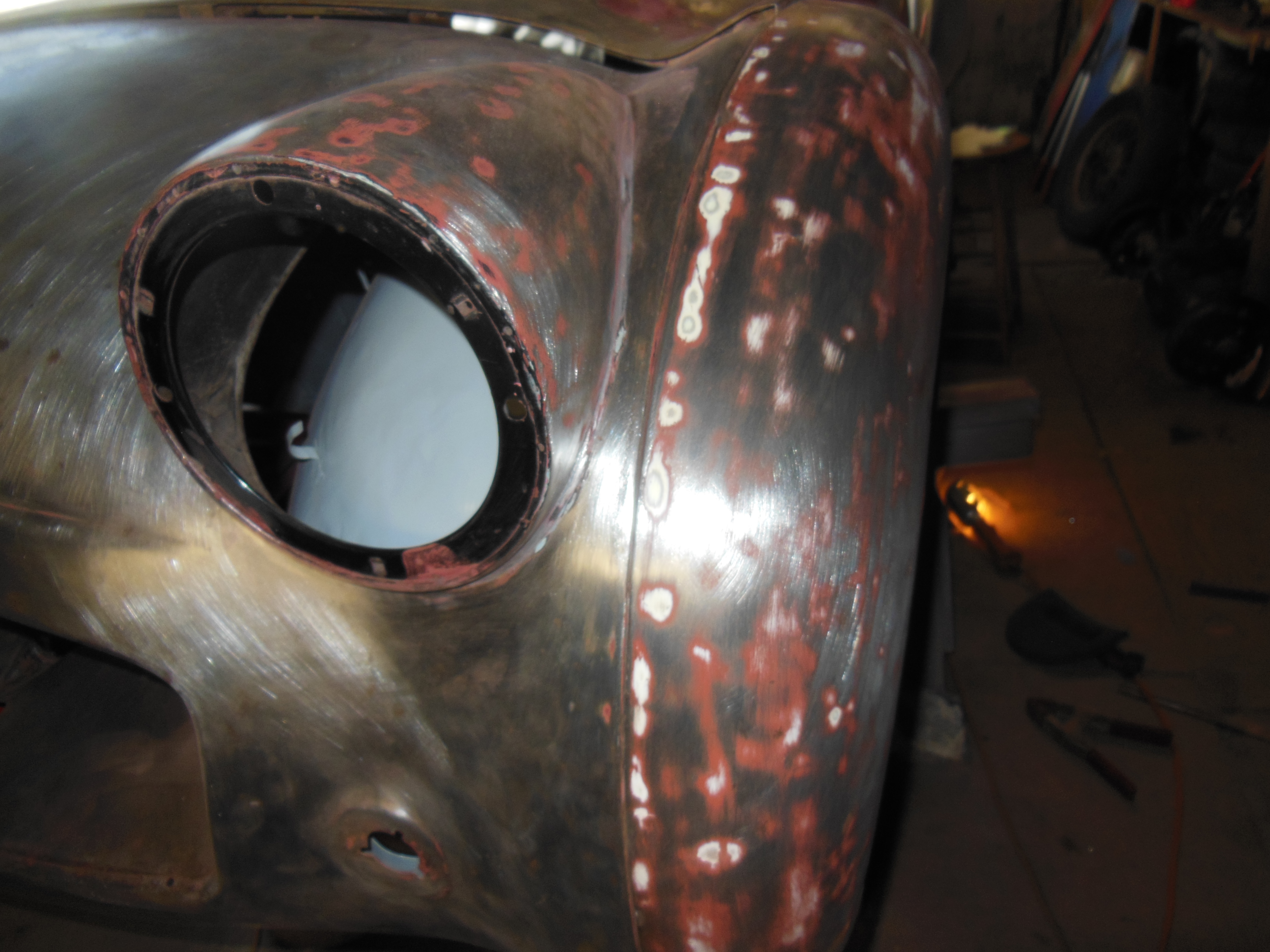

Took some pictures of the progress on the tr2 and wanted to ask some ideas about getting the last little bit of paint off the car. The car has a lot of those little dings and low spots with the primmer and some paint inside the dings. The CRE primmer I am using states they would like an 80 grit texture on the metal. My fear is the 80 grit is too much for the thin metal and before I get all the paint out of the dings I am going to do some kind of damage, like sand the car to dust.
I used a 8 inch mud hog 8 sander where I could and die grinders plus paint remover and then hand sanding with 80 grit. Maybe I should remove the paint out of the dings with paint remover or perhaps spot sand blasting. Anyways, the 80 grit is freaking me out, and I want to ask what people thought.

Unless you really work on an area, 80 grit should not eat through the metal. That said...if the paint and old primer is well bonded to the metal, you don't have to remove it. You have the option of using it as a base for the next coat of primer.
If you must remove it, and you are to too far along for sand blasting (which it looks like you are), then stripper is the book answer.

Don’t worry about 80 grit… you can get the sand scratches out with your primer surfaces after the epoxy primer.
