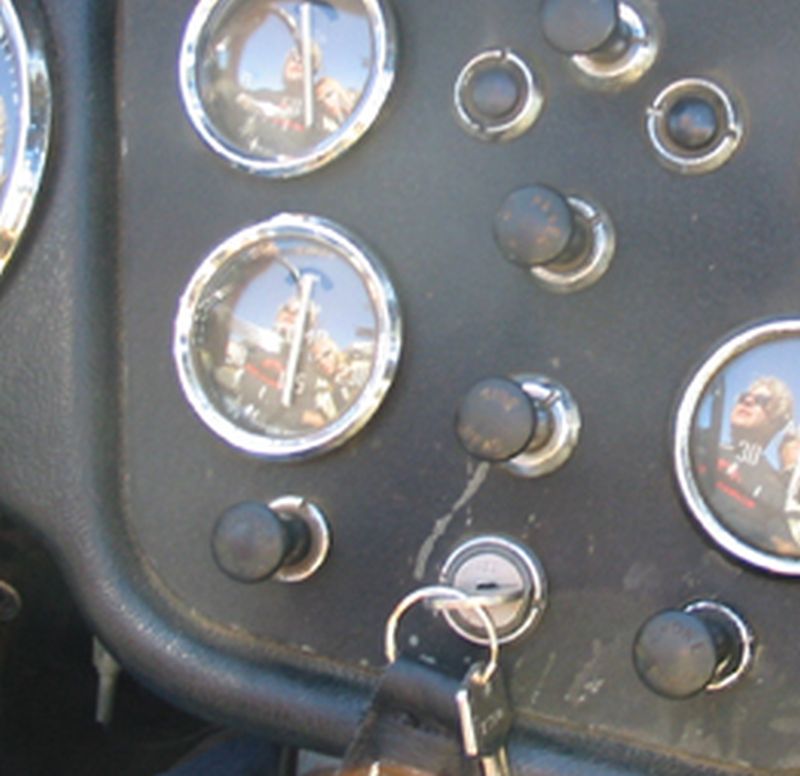

Same thread maybe, but not the same bezel, right? IIRC The starter pushbutton bezel is a rounded ring similar to the ignition switch, while the rheostat bezel has a tapered area, similar to the headlight and wiper switches.
The cars I've owned have all been too early to have the rheostat, but that's what I recall from later cars. This isn't a wonderful photo (blown up quite a bit) but maybe you can see what I'm talking about:

<span style="font-size: 11pt"><span style="color: #003300">Randall, You're absolutely correct; Same thread, different design BUT I've seen 100 point cars (back east) with the incorrect design & no points off.
....Your photo is the correct configuration.
....Note that when the rheostat was introduced it had to be moved down one because it would no longer fit in the top hole (wouldn't clear the ignition/turn lights)
....The photo in Piggott's <span style="font-style: italic">Original Triumph TR2/3/3A</span>,p46 is incorrect & misleading to the contentious restorer.</span></span>

Right. The panel itself is also different, because the rheostat takes a larger hole than the wiper switch (which was in that position on earlier cars with the on/off for the panel lights).
