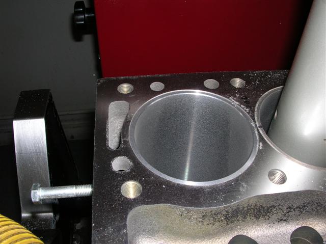

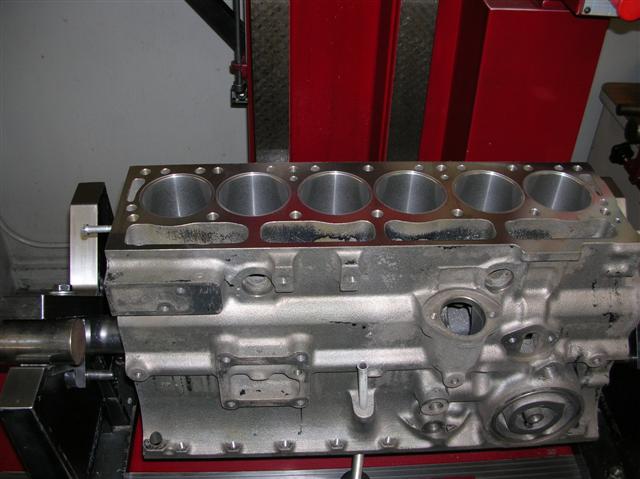

The later blocks have a recess for the head gasket, the heads do not.
If you've got the recessed block, you'll need the later head gasket.
If you've got the non-recessed block you'll need the earlier (copper) head gasket.
The recess was to locate the head gasket & reduce HG failures. Some folks think it worked, some think it made it worse.

Here's a couple pictures, one of a recessed block and the other of a late head machined as any TR6 head would look.
