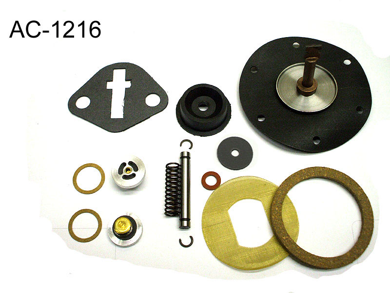

My preference would be for rebuilding the original. The kit I got from TRF fit and worked perfectly, but of course that was for a TR3 and the TR6 kit is different.

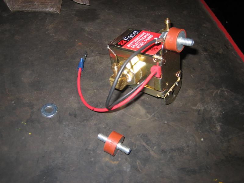

For an electric pump, I like the little square Facet pumps. They come in a variety of pressures though, so be sure to get one that matches what your carbs want. I think that is model 40163, maybe someone else knows for sure. Aircraft Spruce is the cheapest source of new ones that I know of (excluding some clones that look identical but aren't as well made)
https://www.aircraftspruce.com/catalog/eppages/facetpumps.php
However, they seem very reliable, so I bought my last one on flea-bay for $20.
There is a Ford fuel filter that screws into the inlet and has a hose barb on the other side. Probably a good idea; but the bare pump seems very tolerant of crud in the fuel, so maybe not required.
Probably the biggest downside of the Facet is that they are kind of noisy. If you just bolt them to flat sheet metal, the metal amplifies the noise and makes it annoying. For the one in my Stag, I developed a double rubber mount, with rubber between the pump and a bracket, then more rubber between the bracket and the original fuel pump bracket. You can still hear the pump if you listen closely with the engine off, but the exhaust burble covers it up nicely.

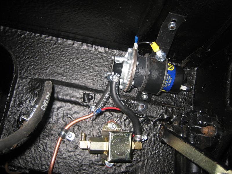

I put the Facet 40104 in my TR6 about two years ago; I don't see why the 40163 wouldn't work as Randall points out. It is noisy but I also used some rubber between the pump base and the frame.

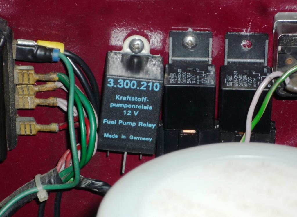

One more thing... I also used a fuel pump relay from an '85 Rabbit; it senses the rotation of the distributor and energizes the fuel pump. If the distributor is not turning, there is no +12v to the pump. It's a safety feature in case of an accident. I also need to install an inertia switch which is on my "to do" list.
Edit..... here's a pic of the fuel pump relay I used

I rebuilt my TR250 pump and it has been going for four or five years now no problem. I don't remember where I got the rebuild kit. but the rebuild was a fairly straightforward process, plus you can do most of the work on a table or workbench, not upside down under the car or dash, always a bonus. P.S. if the only issue is the leak at the top I would go the route of making a new gasket as suggested by Jeff above
If TRF has their rebuild kits in stock, it's a good purchase. I can vouch for their quality....cured the GT6's hard starting...still going strong...four driving seasons later.
