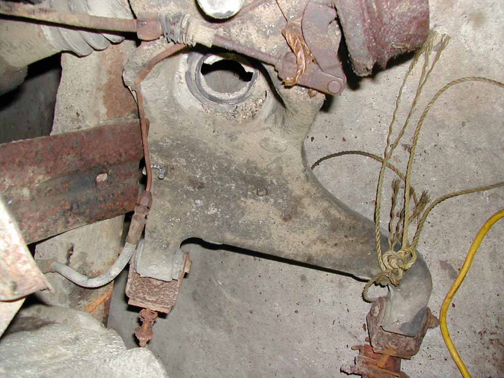

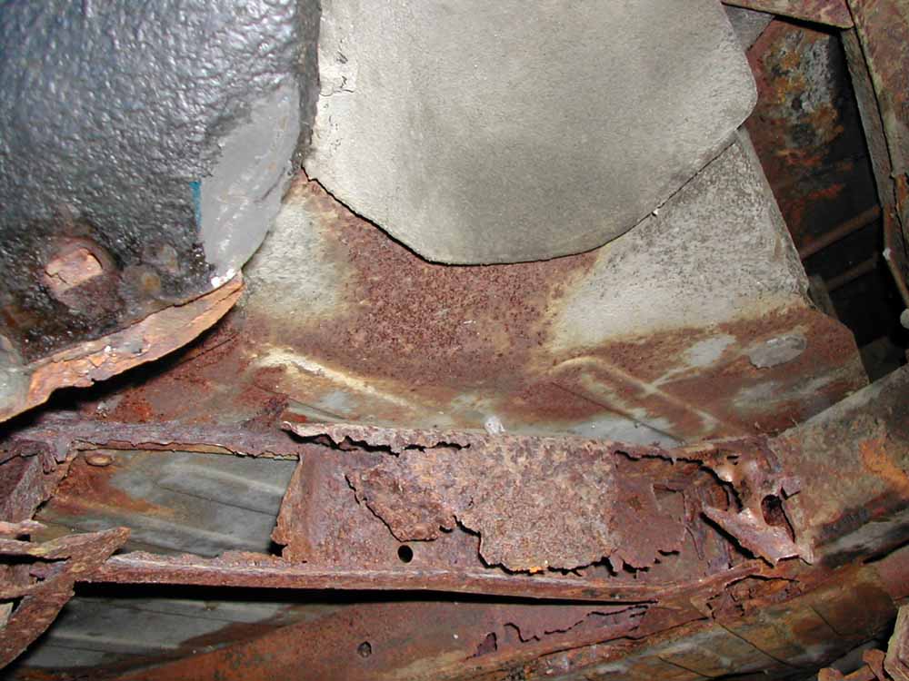

Don't shoot me but its not a TR4 but a TR250 sorry MG's are what I know not Triumphs but any why here are some pics hope u can see them alright

Hi again Mark,
That changes things a lot! TR250 used the IRS frame, which is available from Ratco now. It also explains to some degree why it's in such bad shape. The later frame was not made from as heavy material and might not have had even the small amount of internal protection the earlier one appears to have receieved. Also, the later design leaves several key gaps for moisture and dirt to enter, get trapped inside and cause the frame tubes to rust from the inside out.
The pictures you posted do look pretty bad. However, if the damage is localized to that rear area, all those parts are available and it might actually be rebuildable. Hard to say without close inspection of the remainder of the frame.
There are some modifications and reinforcements recommended in these areas, anyway.
Except for the upper bridge between with the spring perches and diff mounts, I think the rest of the parts can actually be made up relaltively easily from plain sheet steel and tubing, by any really good frame/sheet metal shop.
One thing that's sometimes overlooked when doing this is that the two diagonal frame members where the trailing arms mount actually have some structural members inside them, to prevent the box section from collapsing when the trailing arm bracket bolts are tightened down.
The replacement parts that are available for these areas are all done to original specs. This would actually be a good place to beef things up with a heavier gauge material. The differential mounts in the bridge piece also should be strengthened, while so easily accessed.
The body-off frame work might offer a good opportunity to install a tube shock conversion, too. It's also a good time to run new brake and fuel lines, and even install a new exhaust system. All this is much more easily done before the body is reinstalled, if any of it is under consideration.
