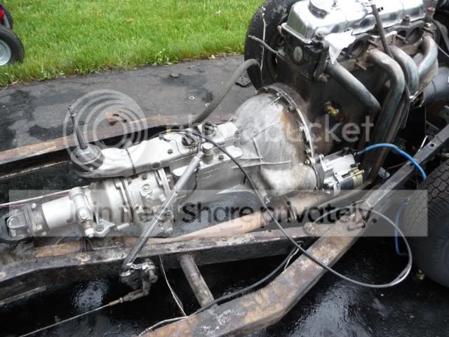

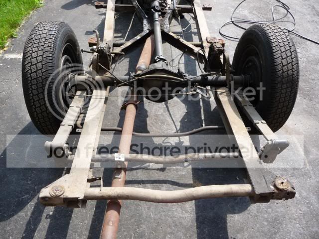

Hey there Paul,
Don't have a direct reponse to your question, but I can tell you that my car when I bought it, and the way it was raced for many years, was with a straight through cherry bomb style exhaust.
You can see it in the pic below
FYI, running with a header as well
M. Pied Lourd
