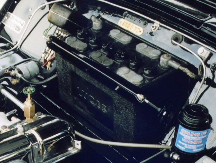

FWIW you can get that Moss phony old batt cover that goes over te Optima and rework it to cover about anything....I used it to hide my modern gel batt.
What battery cover is that?
The "LUCAS" battery I bought from Antique Battery Co. in Hudson Ohio 7 years ago still works fine. I got 5 years out of each of the two earlier batteries I bought from them.
Whatever you buy, make sure that the + battery post is located on top of the battery where it should be for the shortest cable depending on whether you have + ground or negative ground.

When I tried to search their site for a battery cover, I got nowhere. Would never have guessed that they call it a "tar topper".
