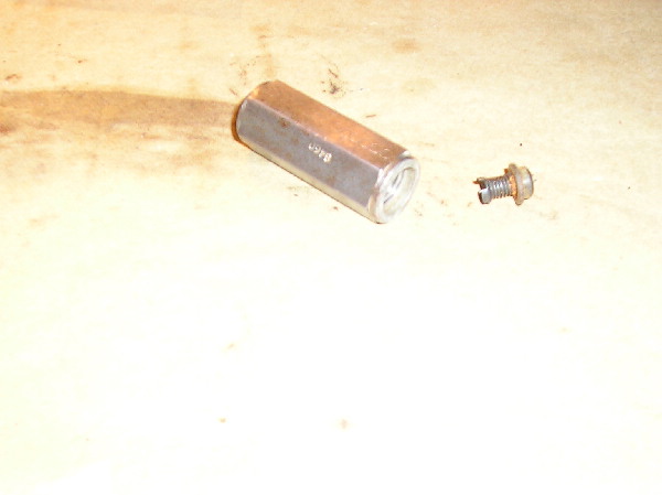

Afternoon, raining cats & dogs outside, so, no yard work today, Yea! Preparing for bending and assembling of the brake lines and from previous threads I noted that several of you have suggested removing the interior components of the valve. I wasn't even sure that I still had the valve. I do and I have taken it apart and in the photo you can see what I found in the valve. There is also a spring in there. I feel that someone has taken it apart and did not put all of the components back in. in fact the little screw really just fell out. since there is a part or parts missing should I toss the screw and spring, give it a good cleaning and reassemble it? Or should I try to get a whole used unit in good shape?
As always your thoughts are appreciated!

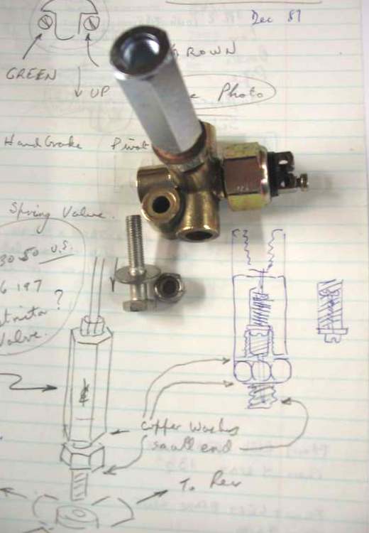

FYI - the diagram from when I removed mine about 7 years ago:
You need a little more than what your picture shows.

Here's another shot of the guts of the RPV. Looks like you are only missing the larger spring. (Click on the image for a larger version)

Well, judging from the pictures and the diagrams I have everything that I need for the restrictor valve. The spring is still inside the valve so its all there. I guess that I will put the innards, cleaned up, into storage and put it together and see if I like the way it works. As Moses indicated I can always put it back in.
Thanks for all your thoughts, pictures and diagrams. Sure helps.
