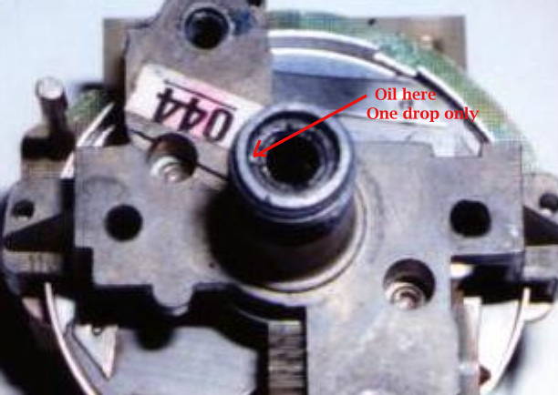

If you look closely at the threaded piece, you may be able to see a small 'step' just inside the tip. That step is where the part that turns with the cable rides against the housing, which can get dry and squeak. That is where you want to put the oil.
Randall & Andrew,
Thanks for your help. I'm sorry but when you say "the threaded piece, you may be able to see a small 'step' just inside the tip," are you referring to the plastic piece that is part of the actual metal cable housed inside the conduit that sticks out and goes in to the back of the tach, or the piece that is part of the tach that has threads on it that receives the plastic nut? Sometime I can be a bit dense. Thanks.
That's it. Maybe a photo (stolen from Tony Rhodes, my camera died) will help:

But the important point here is that you must remove the inner cable, and add a small amount of grease only where it rubs against the outer housing. You don't want a blob of grease in the cavity where the cable joins with the speedo head, so wipe out any that remains there after reinserting the inner cable into the outer cable.
Randall,
Thank you so much. A picture is worth a thousand words!! I didn't actually put any grease in the cavity where the cable goes into the tach head. I did try to cram some between the inner and outer cable after I removed it from the tach. I'm sure that can't hurt. The squeek seems to be coming from the back of the tach so I think following your advice and putting a drop of oil where the cable rides against the housing will do the trick. If not, then I'll remove and grease the whole cable.
