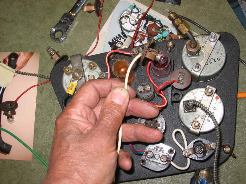

Did you know that the tiny serrations on a dime will hold the dime securely between the lugs where the wires are connected - at least it works on my 1958 TR3A. If you find you have lost your key, it takes only a second to reach up under the dash and "squeeze" the dime into place securely.
Then you can "steal" your own TR without having a key !
Or you can steal someone elses TR !
Or someone might steal yours !
Think about it. This is why I remove the rotor when I park my TR3A in a place where I can't keep an eye on it or if I'm leaving it unattended for longer than 15 minutes.

Don: Aren't you going to tell us about that oil gauge extension?
What's that all about?
Frank
Frank - That extension tube on my oil gauge is "original". It has been there since I bought TRusty brand new almost 52 years ago. What do you have ?
Randall - You don't even need to carry a spare rotor . I remove my rotor so the TR won't start and leave it fully exposed beside the master cylinder assembly so I don't lose it. Most people would give up if it wouldn't start. They wouldn't even know how to open the engine compartment. And they wouldn't even know to look in my door pocket for the "T" handle.
If you want to steal my TR3A, I know you would find a way. But I'm not worried about you. It's the vandals (not the Randalls) that I'm concerned about.
Regards - Don
I'm kidding, Don, just trying to point out that perhaps it's best to not advertise such things on a public forum. And anyone smart enough to figure out the starter button & handbrake isn't going to have any trouble with the budget locks (my pocket knife turns them just fine).
None of the TRs I've owned or dismantled has had that compression union on the oil line. Just a single steel line from the gauge all the way to the flexible line in the engine compartment. The fitting on the gauge serves as the union.
