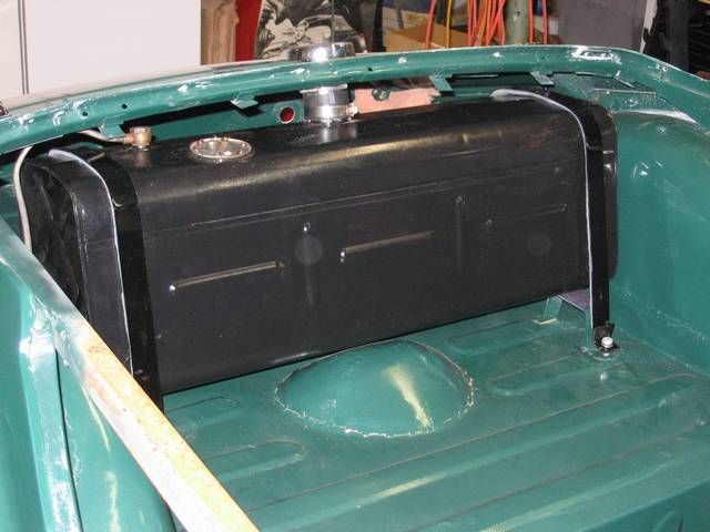

Peter, great picture thanks. Thanks all of you for your thoughts. Guess I will go with felt. Will be in Houston in another week, bet I can find some suitable felt in that huge city. Make sense that the felt would dry out and not hold the water.

I cut some felt strips from the underpadding that was left over after I made the pieces that I put under the floor carpets.
The photo of the green one I finished last year has the same felt strips.
