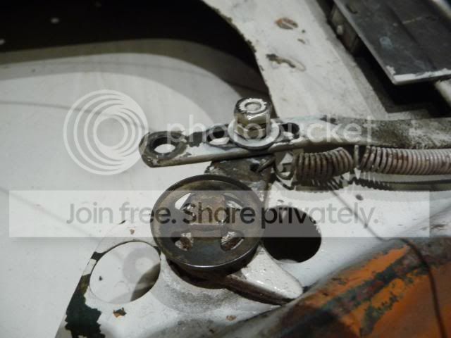

Don`t know if mine is correct (I doubt the double nut is) but here is how mine looked when I took it apart. I am still far away from getting back to worrying about it.....
Cheers,
M. Pied Lourd
Boy! I'm out of it. That pic brings it all back. Disregard any above statement made by this poor, delusional,idiot. hehehe.
