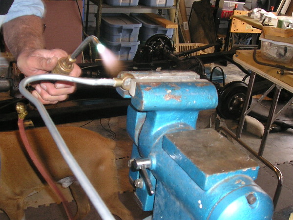

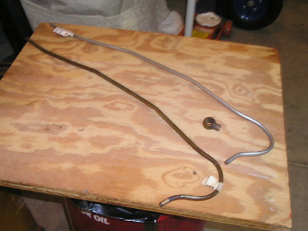

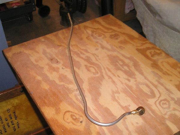

I wrote a while back talking about needing a banjo bolt and a fuel tank vent. Got several suggestions, one was to contact Triumph Rescue. I did and sure enough he was able to help me out with the banjo bolt.
My vent tube was wuthless because of its extended service, also unobtanium, so a buddy of mine came over with a small torch and took the banjo fitting off the pipe. It was silver soldered on. This morning I went to the local parts house that I frequent and he came up with some brake line of the same size and then bent it into the correct shape. $5.00 thanks you. Brought it home my buddy silver soldered it back together and I'm back in business. A few pictures of the event, attached.
