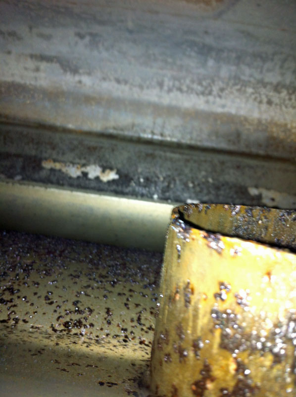

I managed to snap a picture of the inside of the tank, and it doesn't look too bad. When I do get around to cleaning it, for a daily driver, should I just clean it, or also seal it? I hear mixed opinions on sealing. I used the Hirsch sealer on my 4A over 15 years ago, and it seems fine.

Your facing the same question every TR8 owner in the past has had to deal with. You won't know the true extent of the rust until you pull the tank and try to clean it. Remember, the rust comes from the inside out and at the lowest spot where water will accumulate. If you all ready have the tank drained and the pump out, you might as well finish the job. The nasty part of the job is done. Dropping the rear end and the exhaust isn't that big a job.
Well, a PO had the exhaust welded together, so it will be a bit bigger job than usual.
Bummer - I bet you can do a work around however. She wasn't used much before you got her if memory serves, so consider this sorting her out.

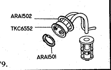

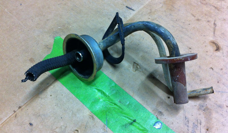

DNK said:
Darrell, What's this?
Hi Don,
That is the fuel pickup and return. You can see a bit of the return hose on the left, and the reddish/brown thing is part of the filter that is supposed to be inside the tank.
-Darrell

Hi Don,
Does this help?
-Darrell

Here is a more or less intact filter.

So your saying that inside my tank is one of these??
If you have a stock FI tank, yes.
Does your tank have one or two holes?
