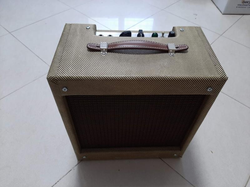

Over the last year my son and I built a 1957 Fender Tweed Princeton clone amp from scratch.
This is a small (about 5 w) practice amp - but way more than powerful enough for the house. Clapton apparently recorded a few songs in studio using this type but his was probably an original.
No hum or other background noise, just a nice clean electric guitar sound.

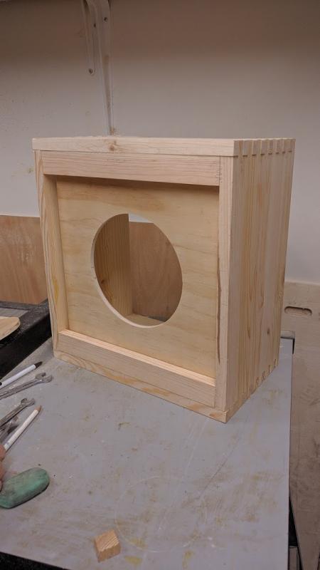

Wooden case made out of a shelf, joints were dovetailed for strength, and because that is how the originals were made.

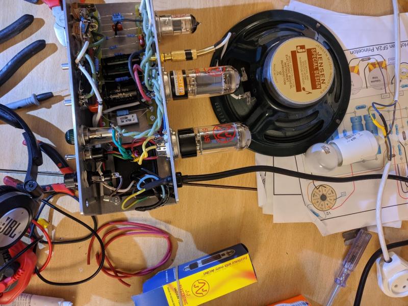

Small mess of electronics. The chassis started out as a flat Al plate, all the electronics were point to point wired. Actually fender would have used an eyelet board but this worked just as well.
Ready to rock. Putting the tweed fabric on was a giant pain and if I ever make another one it is going to have an easier to apply finish! We got the fabric pattern to line up correctly on the top. Some sort of leatherette would have been 1000% easier and less stressful to apply.

No kit involved.
I took a readily available schematic, ordered all the parts needed ( mostly from tubedepot.com) , a few terminal strips and put it all together.
The case used to be a shelf until it had a close encounter with my table saw.
I worked out dimensions and layout by measuring off of a few decent pictures of originals on Reverb.com. Since the original speaker was 8" diameter I used that as a reference to work out all other dimensions.
To learn the special techniques needed for tube wiring (point to point), working the filament circuit without causing hum, biasing tube amps, and getting the tweed material onto the case I studied a few amp restorers / builders on YouTube.
The only advantage of a kit is that it would have had nice silk screened graphics on the control panel. I tried making water transfer decals but they didn't look very good and with only 2 knobs and an on off switch not really needed.
