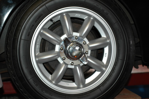

I have KN alloy knock off wheels. The splined hubs are chromed steel attached to the alloy wheels with five 3/8" X 2" fine thread bolts secured with chromed acorn nuts. I think the bolts are grade 8 but they have no head markings, but the hex head has a circle in the middle like the end of a stud flush with the end of a nut. Torque charts indicate a grade 8 bolt can be torqued to 49 ft. lbs and a grade 5 bolt can be torqued to 35 ft. lbs. Will the alloy wheel allow these torques? 35 ft. lbs. felt like plenty with the torque wrench.

This is my first attempt at attaching a picture; I'm having difficulty getting the image down to 120k and then sending it.
Hi JFS, (my first post here) most of the figures people are talking about here are for lug nuts - But I guess you're talking about attaching the spline centers to the alloy wheel? Did the wheels come unassembled or something?
Since they're not really lug nuts, I would try to contact the manufacturer (or perhaps the distributer) for a real spec. You don't wanna ruin you wheels, eh?
I have the bolt-on version of the K&Ns on my 4A. I torque 'em to 55ft/lbs. with torque wrench. No problems so far. (7 yrs.)

Welcome to the forum,Rusticus! I've had these wheels for about 12 years. I spun a hub on one last year and emailed the manufacturer for a new hub but received no reply. The big 3 vendors in the states would only sell me a complete wheel. I finally got a replacement hub from Racetorations. I took them apart this spring to get new tires mounted and balanced. Maybe Racetorations can get me the torques.
