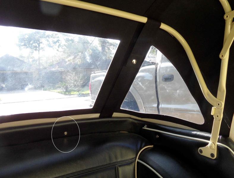

I am replacing the the centre tonneau capping that has the holes for the hardtop with one without holes. Does the "centre" capping mount on top of "rail" cappings? What holds the centre capping in place? Can't seem to find a good pic of this setup.
I think this is correct. Two screws either side, one shown here. It's formed so tightly to the tub, with the top LTD studs close along it's edge that it doesn't take much to hold it in place, including the top webbing.
