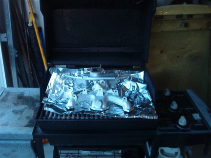

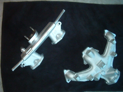

Some of you may remember that a few months ago I was telling you that I painted my manifolds with Hi-Temp paint and then read the instruction that the paint needed to be baked. The general consensus was that I probably didn't need to but every time I touched the parts, they left residue on my hands. Anyway, Saturday Night was the first BBQ of the season and you guessed it, after dinner I threw the parts on the grille for an hour. Yes I have finally lost my senses. Anyway, heres the rub, the finish is magnificant! Looks much nicer than paint (on these parts) and since I don't have access to powder coating, it is a very close second. I've attached pics of you don't believe me.
The Paint is Plasti Kote Aluminum Hi-Temp Paint HP-14

by the way, those parts look great ... don't know about cooking them in your BBQ grill though ....
