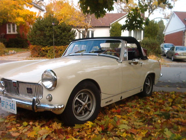

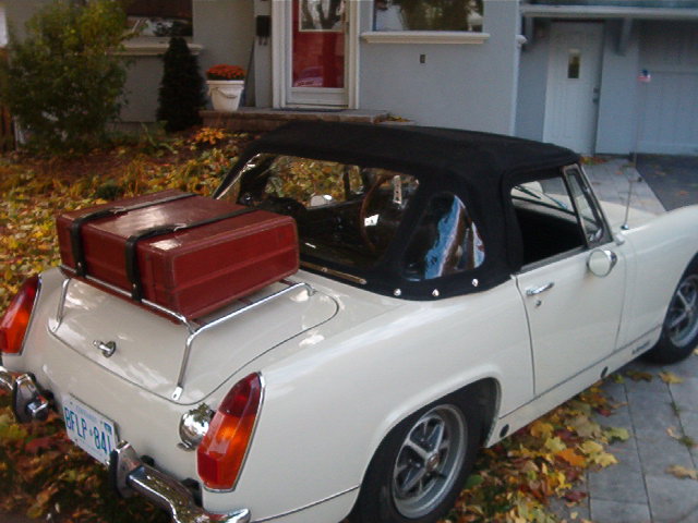

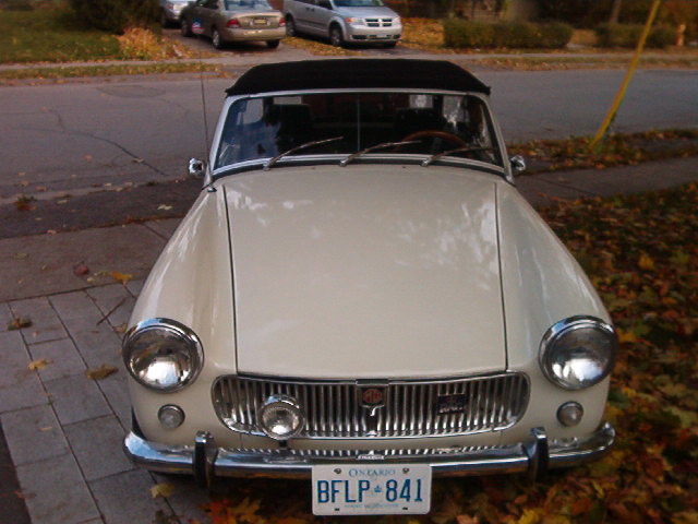

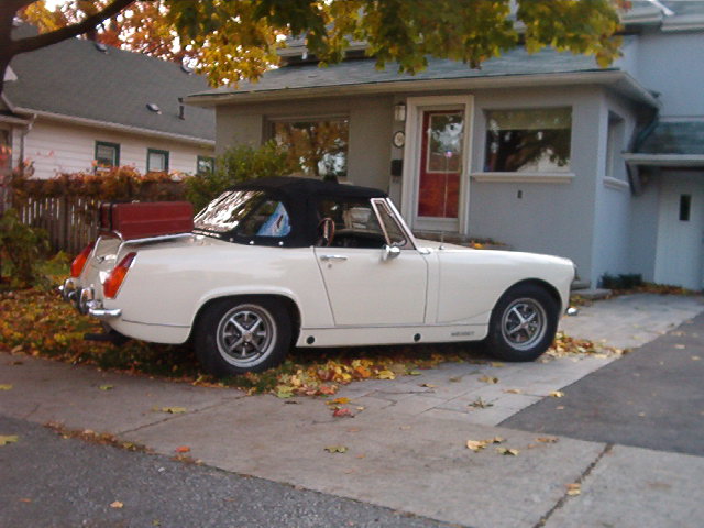

So, first, I have to confess that the top has intimidated the heck out of me, so, I've been dragging it around for at least 3/4 of a year, maybe 1 3/4 of a year, worrying about it. Tonight was the night. First off was cleaning the tool box some - When the movers packed they dumped every little thing they could into it, which, is actually better as stuff doesn't shift, but, I still had to sort.
For those of you who don't remember, I got a really good deal on a canvas top, except, when I tried it last time, and the time before that and even the time before that, the tenex snaps didn't line up, (durn MOWOGS) and, I didn't want to move the male parts of the snaps as I have a tonneau and a parade boot that fit perfectly. Anyway, tonight was the night to start. First off I had to find the centre snap and put it in place - I could then move the tenex snaps (they needed to move outward.) turned out to be not too big a job, actually it was just cutting the holes longer, and, with one exception the snaps cover the whole hole and the last little bit you can't really see.
I am wondering though whether I might have a short cockpit top as it doesn't seem like there is as much overlap at the front as I thought there would be. But, there does seem to be enough. I did decide to call it a night though as I need to get snaps with longer shanks to allow for the strip across the back.
Anyway, here is what I learned.
1. Once again the job wasn't as big as I had made it in my mind - when am I going to learn that lesson
2. So far, Moss snaps are stronger than Michaels snaps
3. Don't buy the Moss snap installer as the Michaels one is identical at about 1/3 the price.
4. When you install snaps it helps if you have 2 or three extra fingers as you have to hold down the insert while hitting the press with a hammer.
anyway, all's well that ends well - so far. will try to find longer snaps tomorrow and hope to have pics before too long.
Oh, and, had to repair the tonneau tonight - looks and fits great. But, had lost a tenex snap over the summer. replaced it and checked the others. Every single tenex was loose at least half a turn. since the snap cost me ten dollars it's probably worth checking from time to time. And, spreading the ends of a divot repair tool I got once upon a time made a great tenex tool.
