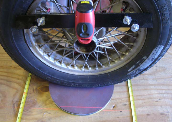

I bought a 1000lb Lazy Susan at a hardware store and sandwiched it with two metal disks. This allows you to adjust the toe while keeping the car on the ground. Here's a mock-up on an old wheel.
Note: The mounting bracket is sized for my 16" wheels and fits on the rims. The tire in the photo is a 15er so the bracket rests on the rubber. Not as accurate.
