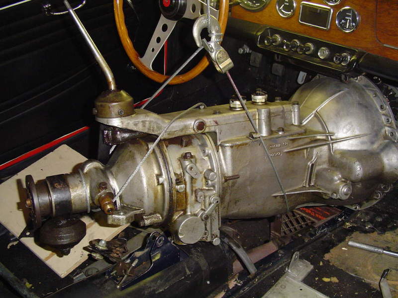

Dear folks,
I am faced with a dilemma. I have to change my ring gear and rear oil seal in my beloved TR6. While the tranny is out, I might as well put in a new clutch. All the parts are sitting in my office (ok, the ring gear is on the way but I am dealing with TRF and ya'll know what that means.)
I have pulled (pushed) the transmission in this car 4 times, this will make the fifth. Those of you that have done this know that physically this is a difficult manuever. I am 60 years old and don't have the back to do this anymore, or would like to keep what back I have left. All my neighbors pretty much don't know me anymore, especially after the last transmission job. They close their blinds when I come knocking. My thoughts are: why not pull the engine and this would give me a better chance to look over some other areas in the car that probably need some attention. May even be a good time to put in the new floor pans. I have access to a really nice portable hydraulic engine hoist with the adjustable bar. I have pulled the engine before and was surprised at how easy it really was. Step one, take down the whole exhaust system. Then pull the carbs, radiator, bonnet, cross member, block off the gas line, and voila, engine out! I can place the engine (sans oil pan) on a rectangular box made out of 4x4's and just wiggle the tranny off from there. Then I can easily access the flywheel and rear seal. Putting the tranny back on is a lot easier at sea level than from atop the car. Just slip it on with the tailpiece chocked for support. The biggest kicker, besides pulling the exhaust out (I have SS headers and custom system so it really does have to come out), is getting the darn bonnet back on perfectly. Has anyone ever thought of indexing the hinge plate of the bonnet by drilling and placing a few small bolts though the hinge plate into the body so that putting it back would only entail locating these holes with the screws or bolts and going right back to where I started, perfect alignment. Besides a really long run-on sentence, what problems will I creat and would this be the thing to do. Anyway, thoughts would be appreciated.
