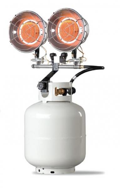

PS, these things work surprisingly well in a cold garage. The radiant heat will warm your clothes and skin even if it can't get the air very warm.
https://www.tractorsupply.com/en/st...-radiant-certified-tank-top-heater-30000-btus
