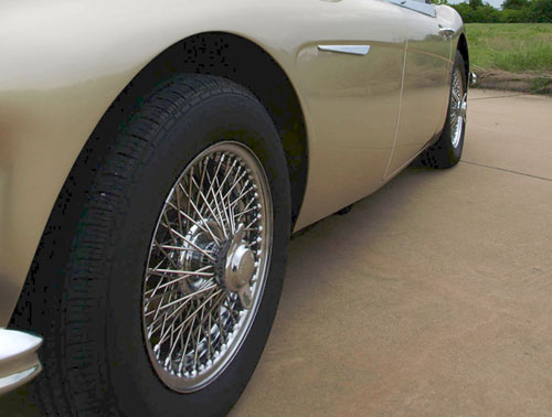

If you're price sensitive, make sure you check eBay! That's where I got mine... a set of five Federal SS657, size 165/80R15. I read somewhere that this was the closest modern size to the original size. Many put wider tires on, but I was specifically looking for narrow, like the originals, as I really like the look on these cars. But anyway... I got the Federals just a few months ago for $50 a piece! They are really nice tires, and I picked them specifically because 1) Federal is a good name and doesn't sound like I'm putting Japanese tires on my classic British car (even though they are in fact Taiwanese), and 2) I liked the way the sidewalls look.
If you're thinking the same size, you'll find a few choices still around on eBay, from reputable sellers, for around the $50-$60 range.
I had the tires shipped straight from the seller to Hendrix Wire Wheel, while simultaneously shipping my four original wheels. The guys at Hendrix trued my wheels, installed new tubes, mounted, balanced and shaved the tires... plus I bought a fifth brand new wire wheel through them from Dayton. For all the service they did, plus the new wheel, plus the tires... I was extremely happy with the money I spent. Excellent value per dollar!
Hendrix did a really fantastic job as well. I can't believe how smooth the car drives, even at high freeway speeds.

Bob, actually, Allen did at Hendrix Wire Wheel. He checked it immediately upon receipt to let me know. They were just shy of 2 years old. His opinion was that they still had a good 8 years of life in them, and told me I did good with the deal I got. Even if I get 5 years out of them... at $50 a piece I'm very happy. Plus, Federal apparently quit making this tire size, so this was the only way I could get them (I really like their overall appearance and tread... too bad the stopped making them!). I would recommend though that anyone buying tires from eBay, or from any wholesaler, should ask for date codes prior to purchase!
~Robert

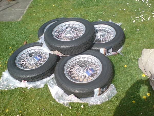

I have decided to get rid of my chromes and old tyres and replace with original spec MWS painted 60 spoke wheels (4.5j 60 spoke on a bj8) and the best tyre option (i'm in the uk) seems to be the Vredstein sprint classic 165hr15's for the money.
A good tyre check for sizing is Longstone tyres:
https://www.longstonetyres.co.uk/Austin-Healey.php

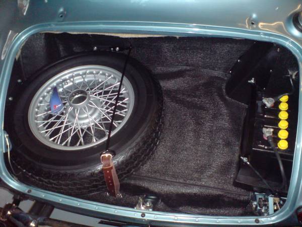

heres my new ones: (spare seems to fit fine in boot - may have problems with 175's?)

polished them twice after they came out of the wrappers!
most uk vendors dont recommend or guarantee after 6 years, how would your insurance hold up with 8 year old tyres, and a blow out writes your car off?
