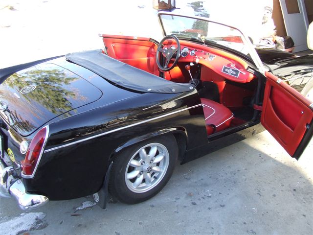

I have minilites on my 63 and am running 155/80 GoodYears on it. There is about 1.5 inches clearance between the sidewall and the wheelwell in back. They are pretty soft and stick well. A nice plus is the tires are only 32.00 each. They might be a little narrow for your liking, but it might give you an idea. I have never tried it, but I heard somehere that the widest tire you can put on a square well car with 5.5 minilites is a 165/70. Has anyone put anything wider on without rubbing?

That is a nice looking MG.
