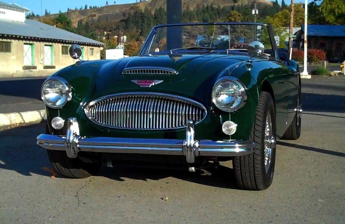

Nope, I ran 205's on my BJ8.

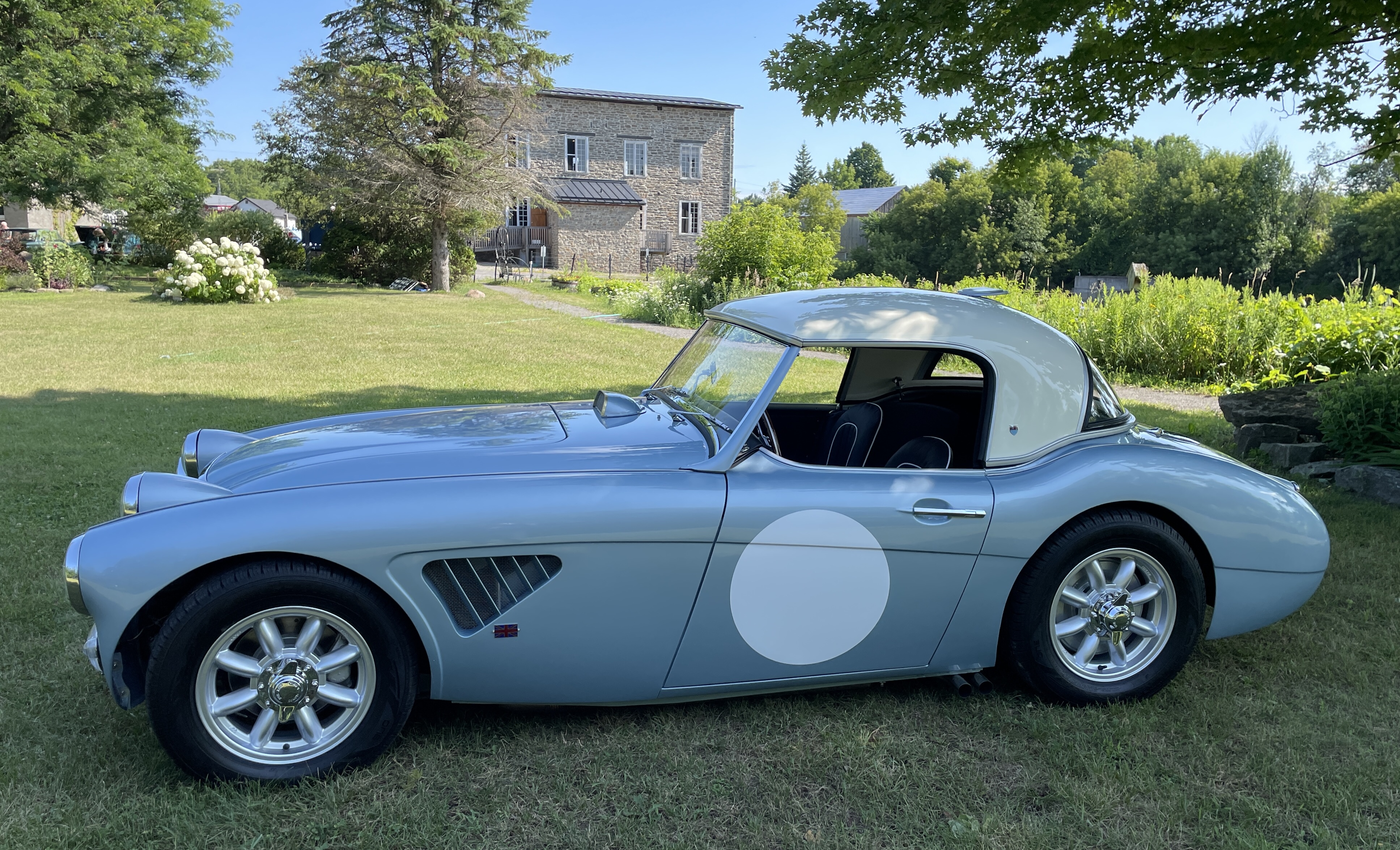

195/65 15s , suspension lowered by 1” front and rear . No rubbing even at full lock .
There are tire size calculators online where you can determine the overall tire details so you decide if your speedometer will need recalibration .

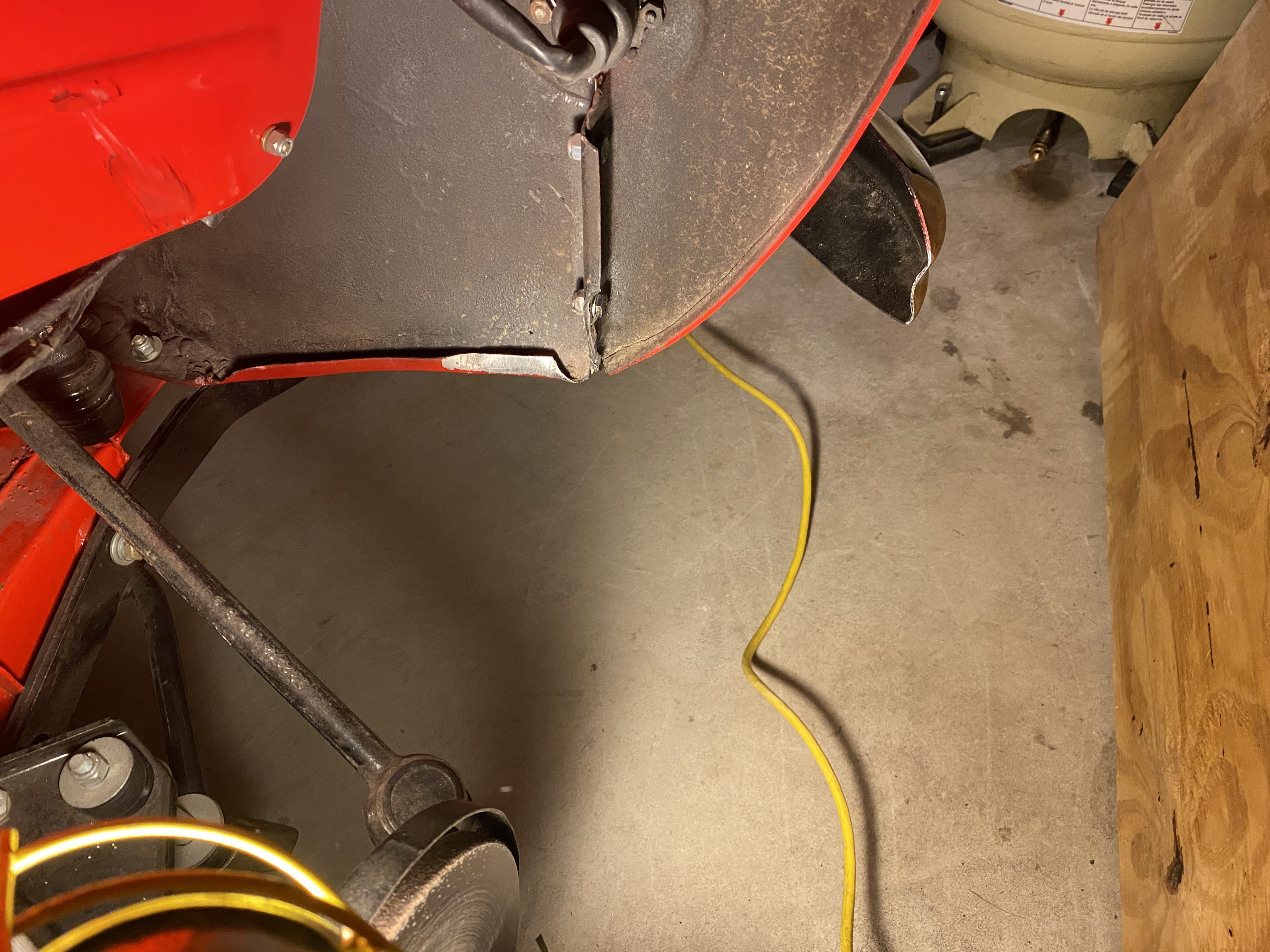

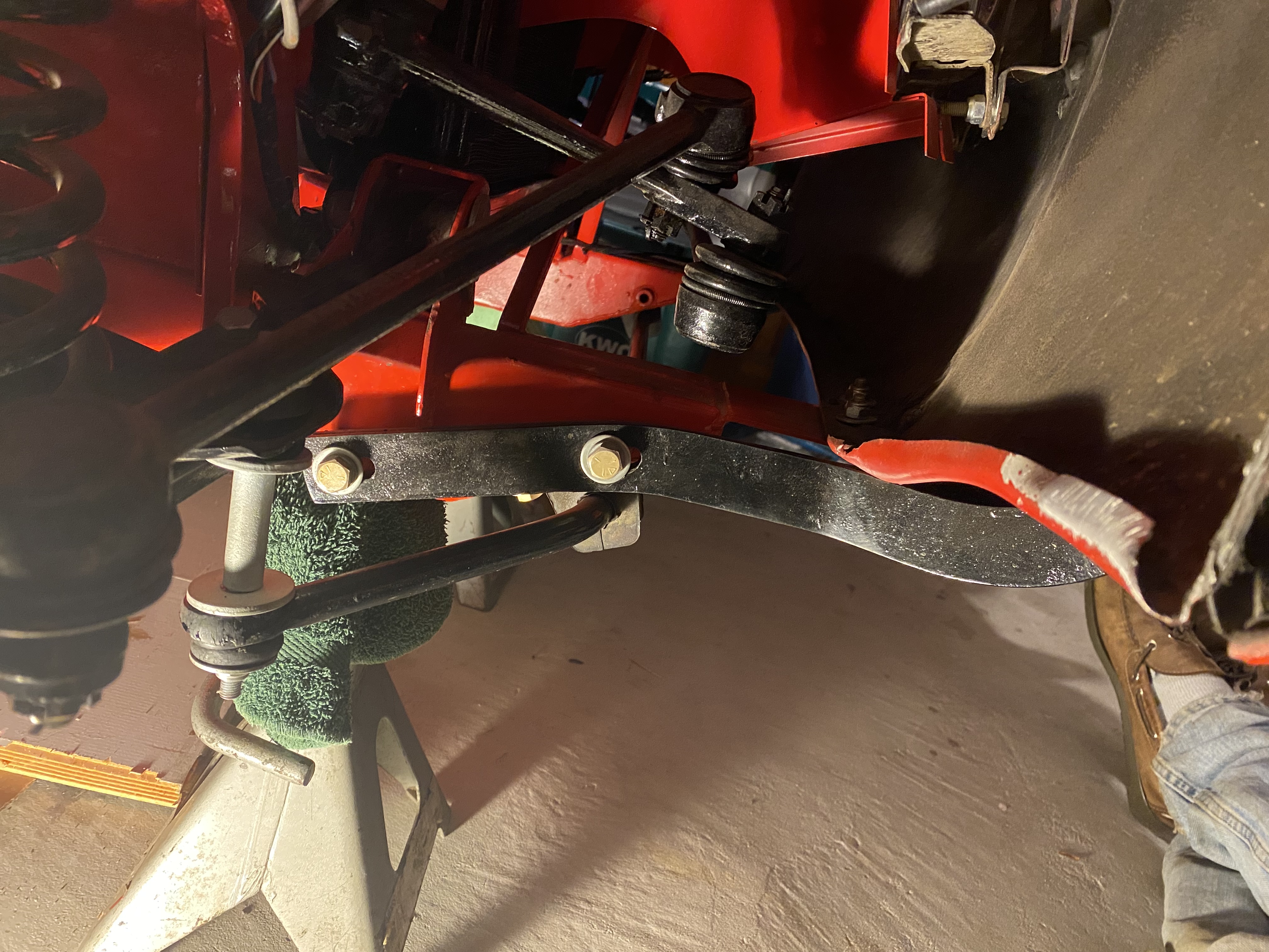

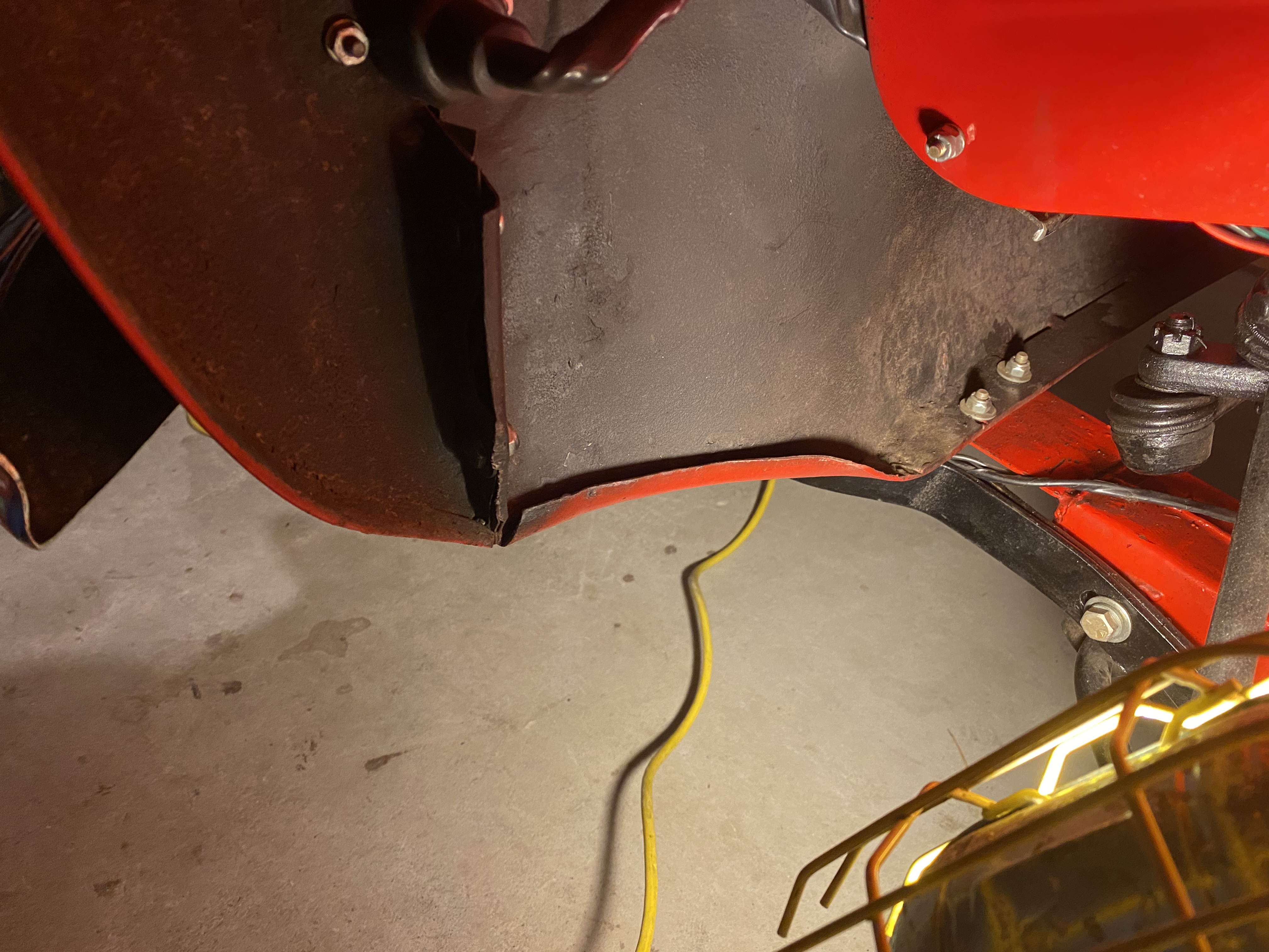

Noticed this scuffed area on passengers front once the tires were out. I’m waiting on the same size 185HR15, but think I made a mistake and should go with 185 70 15.
26.5 vs 25.2 diameter. The original tires were old and I noticed a shaking at about 20mph. Now I’m thinking it was caused by the tire rubbing. No scuff marks on the drivers front.

I doubt that scuffed flange in the front shroud is from tire rubbing. That flange is bent upwards - the tire surface direction at that point would be downwards when driving forward so if it touched/rubbed I would expect the edge of that flange to catch on the rubber tire and bend downwards with the wheel rotation.

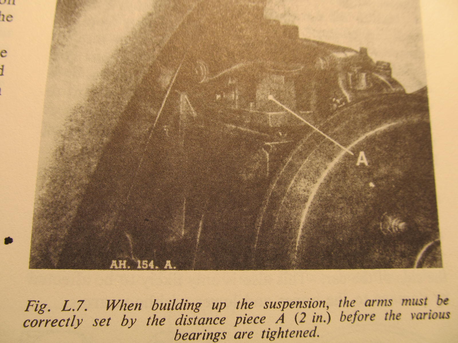

An easy way to check clearance (while it's on stands) is to jack up under the kingpin until you can insert a 2" block of wood under the shock arm opposite the rubber bumper as shown in the attached picture of figure L.7 in section L of the original factory manual (lousy picture but it's all I have). This sets the ride height and places the wheel about where it will be under load going down the road - install the wheel and spin by hand while moving the steering through the range left & right and see if/where there is any contact.
