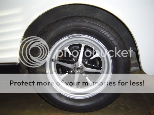

The Sumimotos are the way to go for new tires, but when I purchased my '74 Midget it had <span style="font-weight: bold">175/70 R-13 82S Michelein X Radials </span>. They are excellent tires for this car. Relatively sticky and hold the road nicely, rain or shine.
Not sure if this size will fit the rear wheel wells of a non-RWA car, though. They fit the stock rostyle wheels nicely and look a bit "fat", or racy, too.
FWIW. :thumbsup:
