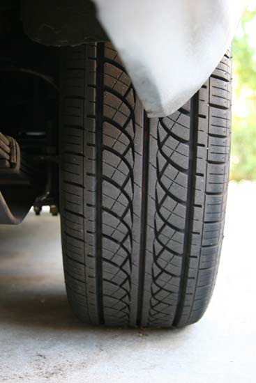

Steve do you happen to have a pic of the `Bridgestone Turanza LS H, and are you running 195.60R14 on your car?

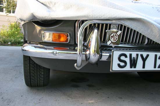

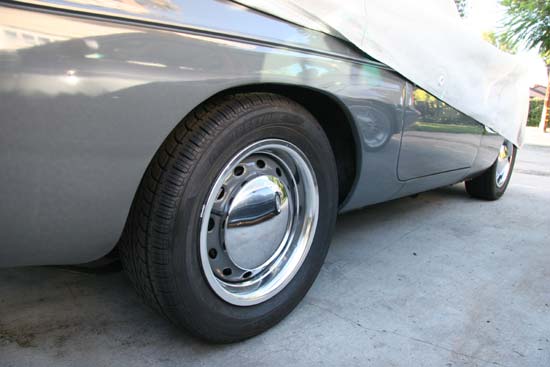

Here are a couple angles showing the fit on 14x5" wheels, stock '67 ride height. The tires are 195/60R14 which are slightly smaller diameter than stock, but they fit and the sidewalls aren't too big. I prefer 195/60R15 but I want to keep the original GT-only disc wheels.
No problem with hitting or rubbing?
None at all. I have 195/60R15 Michelin Pilots on 15x5.5" 72-spoke wires on my '65 MGB, also with no rubbing.
