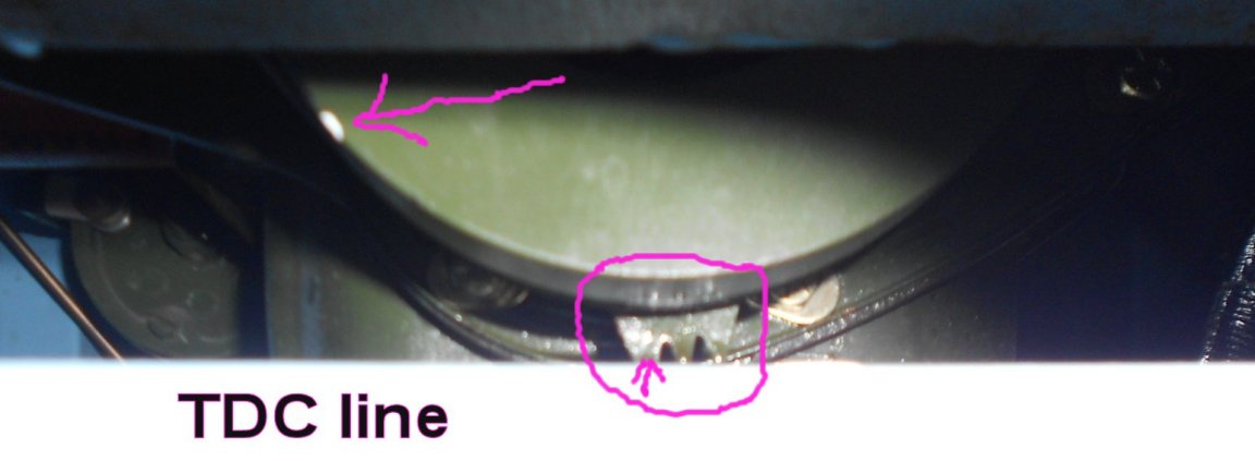

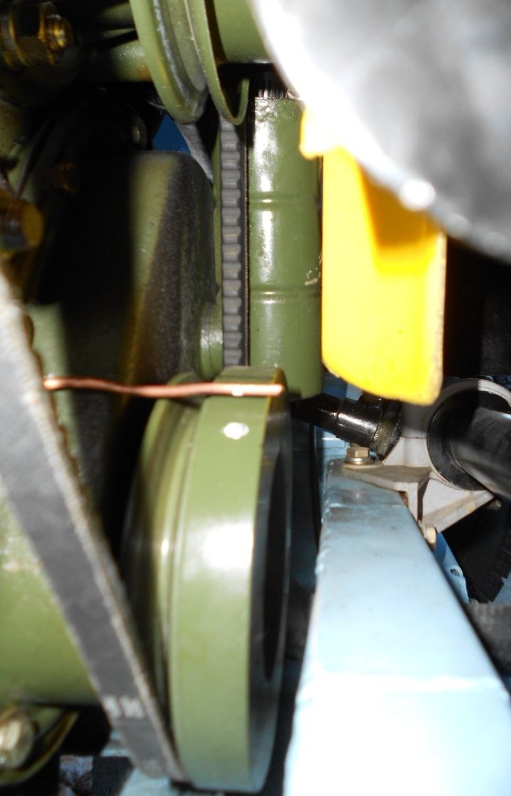

Do you have the toothy-looking marker thing on the bottom of the timing cover? Mine did, but not ANY markings on the pulley/balancer itself (whcih is a 1275), so I had to add my own marker with a wire (once TDC was accurately established). There are a number of photos of these on this board. lower - secondary timing mark.jpg Of course, the tricky part is getting a precise mark for TDC, and there are several ways to do that. I then fabricated a wire pointer that was easier to see. timing mark - first attempt - dot at about 7 degrees.jpg

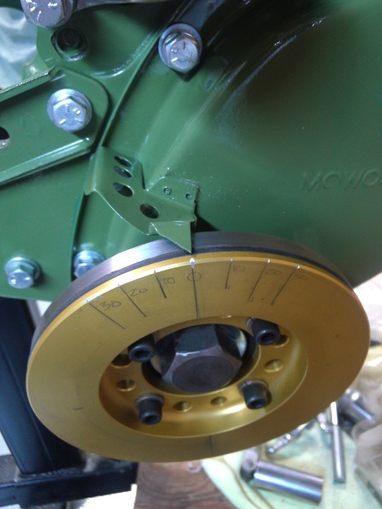

Jeff Schlemmer (Advanced Distributors) sells a kit.
Here's one I fabricated for a recent build:
That's SO much nicer than the wire-based one I made and installed. :joyous:
