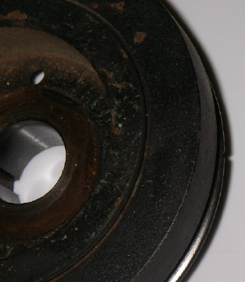

spent 30 minutes under the car, in fourth gear pushing it slowly to turn the pulley, cleaned it with carb cleaner, rubbed it with a cloth, cant fing the darn notch. Unless I go to Dixville notch in NH. At least I still got a sense of humour..... somebody send me a picture......
Can you see it here
Woodie, on the 1275 it's on the edge of the pulley closest to the timing cover. It can be nearly impossible to see with the belt installed unless you are virtually underneath the thing. When you find it, draw a line across the thick part of the damper with a paint marker, in line with the notch.
Jeff
Closest to the timeing cover, now wonder who's bright idea that was.
