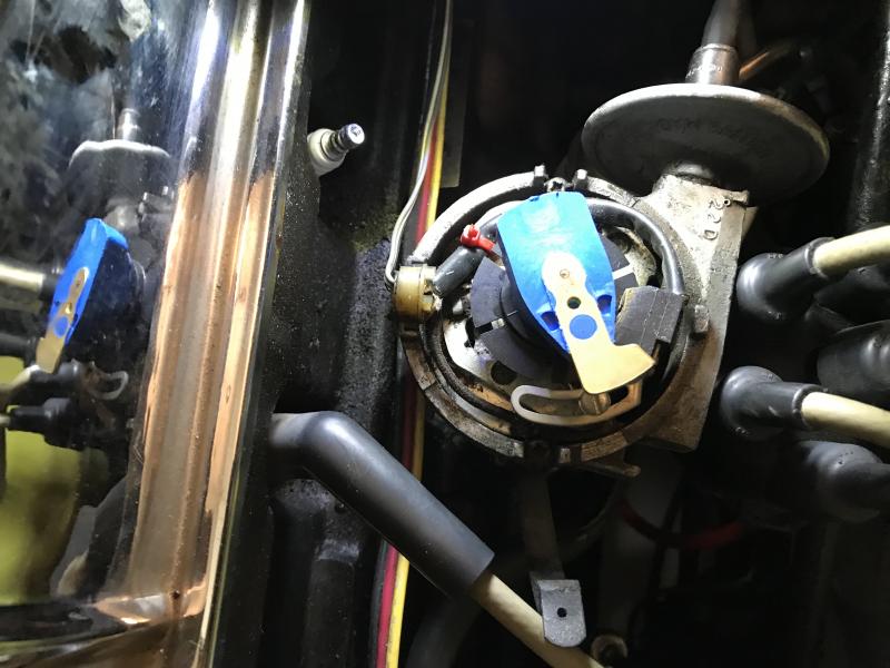

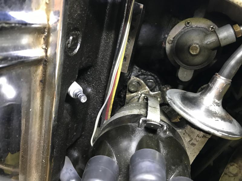

Thanks Doug, It looks like I have the Lucas distributor. Attached is a picture showing the nut that allows for adjustment of the distributor. You can see the slot. The bolt is tight against the end of the slot so no more adjust is available at that point. The second pic is the interior of the distributor. I was looking at the small screw with the slot and wondering if an adjustment can be made there. 6D3C1019-D683-4025-803C-C532927ECB73.jpgFA5FB990-E67C-436B-BEE0-8EFDA96A6D4A.jpg
Pool boy, I think you are right. I’ll take another stab at it by loosing the horizontal clamp. I don’t need much adjustment so this should be the solu5ion.
If the engine appears to be running well, I would not make any adjustments to the placement of the electronic ignition components inside the distributor. I would focus only on that external pinch clamp.
Per our earlier discussion, there are vertical and horizontal bolts for the dizzy clamp. The vertical bolts are shown in your first picture. The long horizontal bolt is not clearly shown but it will be obvious which it is. Loosen the horizontal pinch bolt and turn the distributor body to adjust the timing where you want it.
I also feel it is worth pointing out that you may be missing a distributor component. Your pictures show what appears to be a 25D6 series Lucas distributor. Look at the bottom, right of the distributor body in your second picture. You will see a "C" shaped opening. There is normally a thumb nut in that location. The thumb nut should be mounted on a threaded rod that is connected to the breaker plate. By turning that (missing) thumb nut you are able to advance or retard the timing by a few degrees as needed. The nut really needs to be there so the timing doesn't randomly change on you while driving. Of course... a previous owner may have locked the breaker plate to prevent that wandering timing... but that would also disable the vacuum advance.
I am not very familiar with the 25D6 distributor... only 4 cylinder 25D4. Can someone confirm whether the 25D6 should have the advance/retard thumb nut?
While the thumb wheel can be added to the TR6's Lucas 22D6 distributor with a vacuum Retard module, they didn't come that way.
If added, the retard module would have to have been 'unpinned' so that it can move as the thumb wheel is rotated. The module in "Firstimers" module is pinned, therefore the points plate will only move in reaction to vacuum in the retard module.
