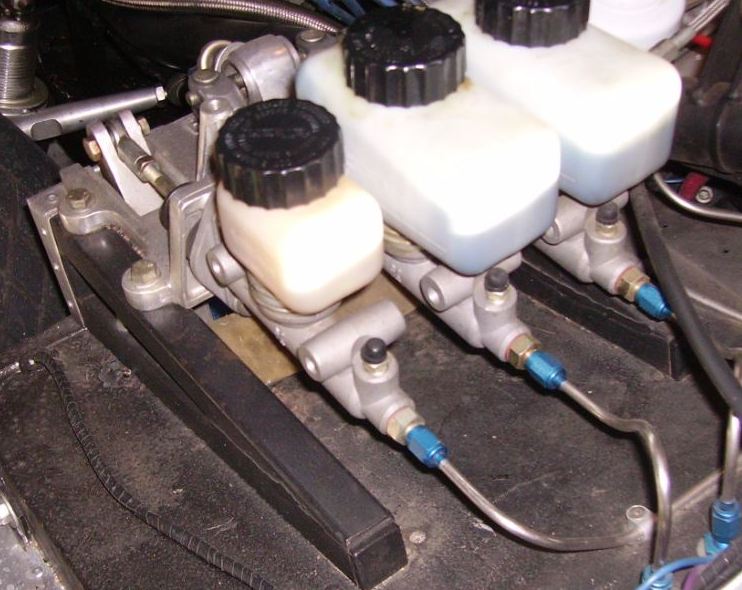

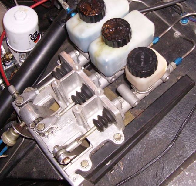

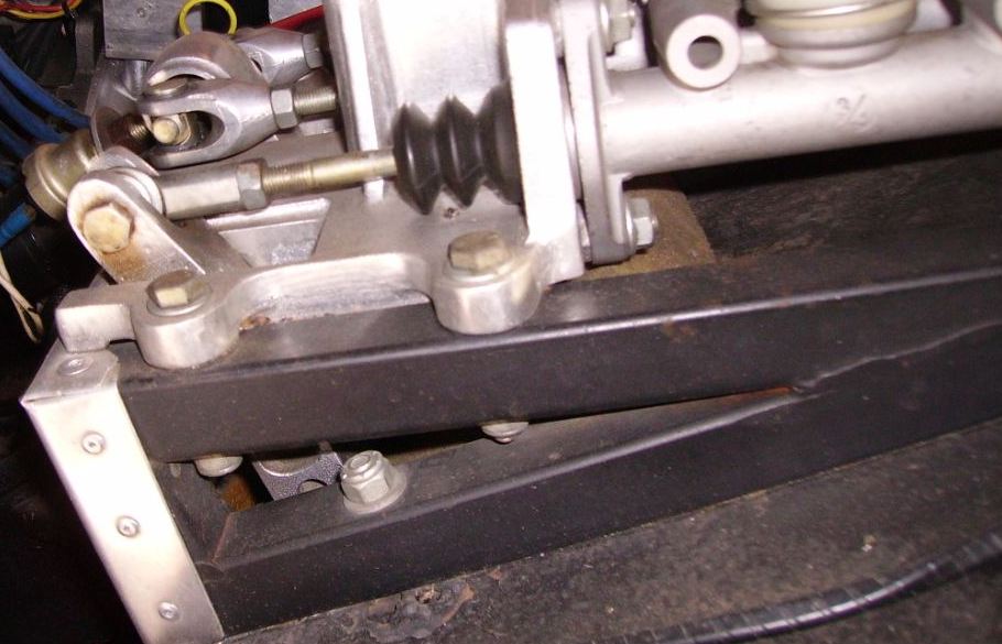

I'm running that set up but I did do all the line with AN fitting and also I'm running mazda RX7 brakes but I'm running 3/4 bore (tryed 1" bore braking was to hard)
I will get out there and take some pic's on how i made the mount

here's a pic

more pic

one more

Question (not totally related): Is that AN bulkhead fitting Aluminum?
yes there all AN Aluminum fitting never had a problem and have been on the car 18 years
I did also have to use a Hydraulic Throttle Pedal
becouse the my mount cover up the hole for the cable

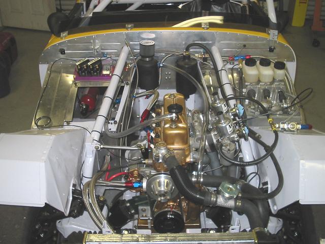

Here's one I did on a SCCA Midget race car I built a few years back.

Dam Hap, I just drolled all over my keyboard. And the thing about that engine is that it most likely runs better than it looks.
nice set up hap :yesnod: is that Accusump set up in too
No we thought about it, but it didn't have one, I had excellent luck without them, just had a SCCA LP 1275 race engine go 24 weekends without one and it had bearings in it that looked new, we use WC supercomp oil pans an they did a good job. What you're probably seeing is the fire system bottle. I also had a Oberg pre filter and remote oil filter mounted in the passenger foot box, thats what the access panel was for, we have the Oberg just before the spin on remote filter adapter, so we could see what was going on in the engine, I'm a big fan of Obergs on race engines.
