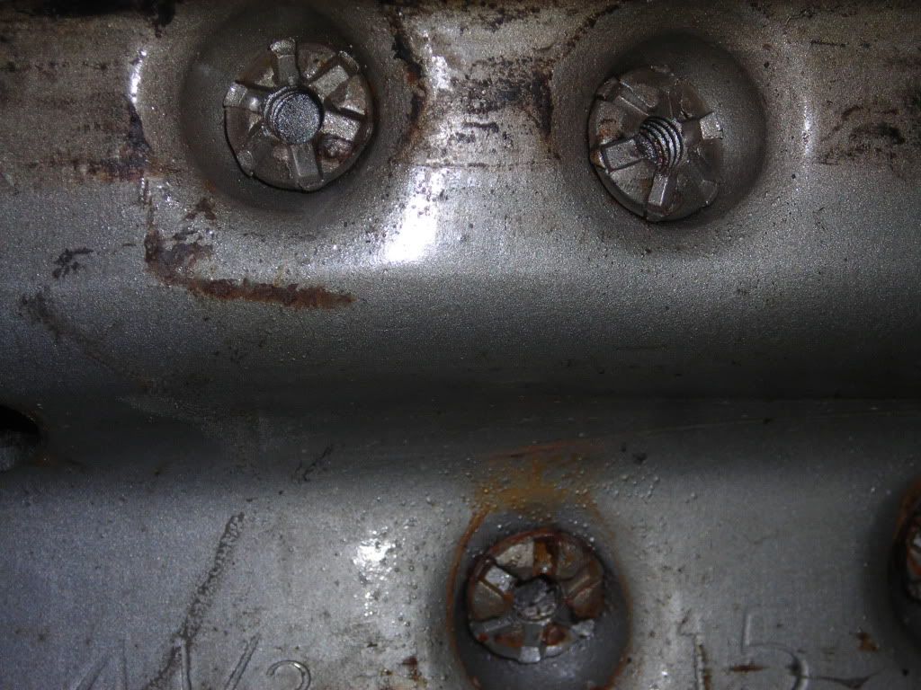

Related to the other post, now that I have the 30+ year old tires off the TR4a wire rims there are a couple of spokes that don't make the same "thunk" sound as all the others.
Picture of the spoke ends inside the inner wheel;
Picts look like rims good. Very little experience with big wheels but having built bike wheels with a hand full of spokes I know you can't just do one spoke and make it true, gotta chase it around. With tires off put em on and spin to see how straight they are. The spokes on my wheels were all frozen but pretty true. I left them alone and did not free. Since have broken a couple spokes and just replaced. If close just replace the "thonks" since they are probably bad anyway. If not true make a mailbox post holder, oh yea, California guy, probably haven't seen that.
Should not be a difficult job. Just keep the rim round and centered about the hub. And make sure it runs true to perpendicular and does not wobble as it turns. Also make sure it maintains the proper offset. And that the spokes are all the same tension and not too tight that they snap. Other than that it should not be too bad of a job.

Lets say you have one spoke that is loose. Sometimes you can just tighten that one and get away with it. But most of the time you have to then tighten 1-3 spokes on either side of it to even it out. So you tight the middle a full turn, the next one takes 3/4 turn the next one takes 1/2 turn and so on. Now you have some other issues to think about. Did tightening these spokes take it out of round on the other side of the rim. Did the rim get pulled over to the right or left at that spot now as well. Sometimes you have to loosen spokes on the other side of the rim or tighten right side spokes and loosen left side spokes.
What ever you do remember you get an opposite reaction on right or left and opposite side of the rim. It helps to have the rim on something that will spin so you can see up and down and right and left movement of the rim as it spins.

You know what nobody has mentioned is the fact that if you have a spoke that goes thunk or one that needs tightening is going to be a real problem unless the nipples are loose and my experience with 40 year old wire wheels is that they are not going to be loose. Those dudes break real easy. In talking to Hendrix they say to use heat. If you send the wheel to them they are not going to spend any time fussing with them , they just replace them, that means three or four spokes to replace one that goes thunk.
Just some ponderable thoughts, Tinkerman
Just called them, nice folks, as you say TD. $125 per wheel plus parts. He told me: A.Not to use heat. B.If you have one that has a frozen nipple that means replacement. I would try PB Blaster or Kroil before I got the bolt cutters out. Remember that general speaking, you have to remove two other spokes beside the one you are replacing. Spoke and nipple for painted wheels $2.25 each set plus shipping.
