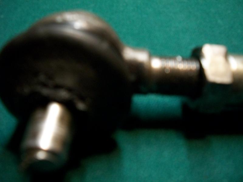

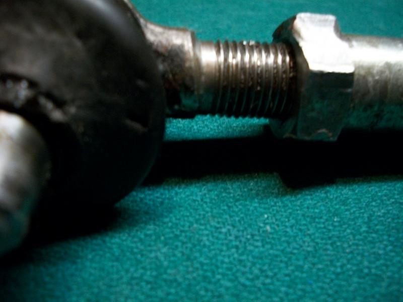

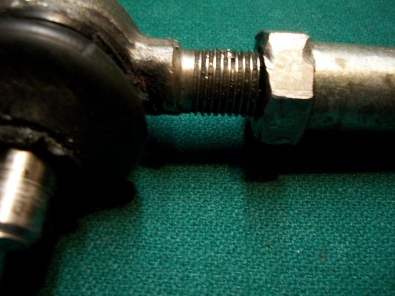

100_2038.jpg100_2037.jpg This is the Passenger side ball joint/tie rod closest to the idler. That nut is "really" on there. To unlock the nut in the pic do I turn it away from me or towards me? No sense working against myself.:eagerness:

Is that a left handed thread in the pic? If so I would turn the lock nut towards me? I had a 12" 7/8 box end on it and it would not budge. I suppose if it could try backing the tie rod itself out but a vice grip would probably ruin it.
Yeah get a 6 point wrench on it; it looks to me-- push north. Should be the opposite of the other end, and yes those threads can bend your mind. I would say left hand there, no right.
Yes, left hand in the photo. With it laying as in the photo, and the wrench sticking up, you would pull the wrench towards you. Or another way to look at it, turn the nut clockwise.

It looks a little like that nut is cross threaded in the photo. Could add to the problem
