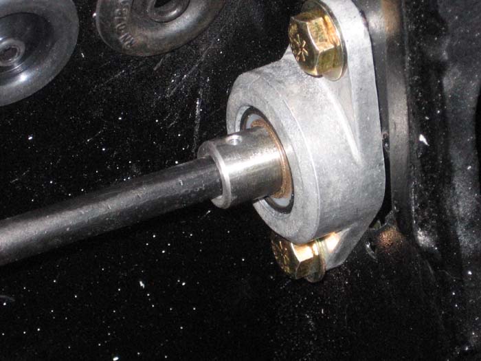

If you're going to change the firewall pedal bushings, you might consider what I did. I got the self aligning bushings from McMaster. I had to make one part for the assembly, but it has worked out great, and is engineered to be replaced very easily if need be.
Art, that looks slick! I'm going to have to remember that!

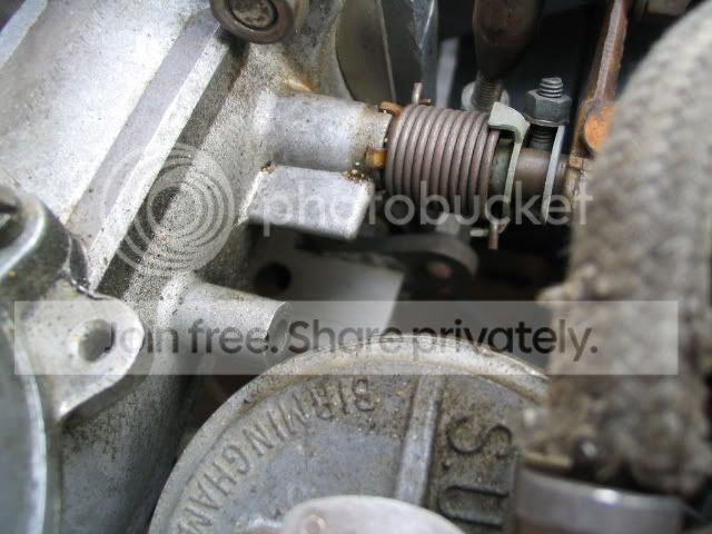

So this morning, had a hard time getting full movement thru the accelerator linkage, and thought I'd gotten bitten reading this thread. Hmmph, gotta replace the bushings; turned out to be something different:
Loosening pivot bolt, rubbing up against ARE carb shield, (might be a little hard to make out). Tightened, regained full movement, yahoo! Next time carbs are out, a little Dremel work will take give me a little more room...
