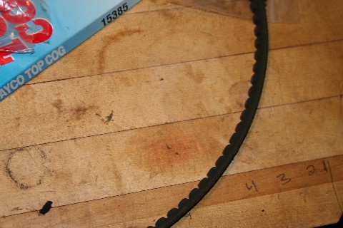

But when it comes to fan belts does it matter which side the cogs are on when it comes to the MGB. Belt shape is identical except for the placement of the cogs. Old belt cogs are on the inside and the new belt cogs are on the outside.

A pick of the "original" is below. Not quite sure how old it actualy is but I know for a fact it's at least 15 years old.

In that original belt pic, the cogs go in towards the pulleys - but cogs aren't necessary.
