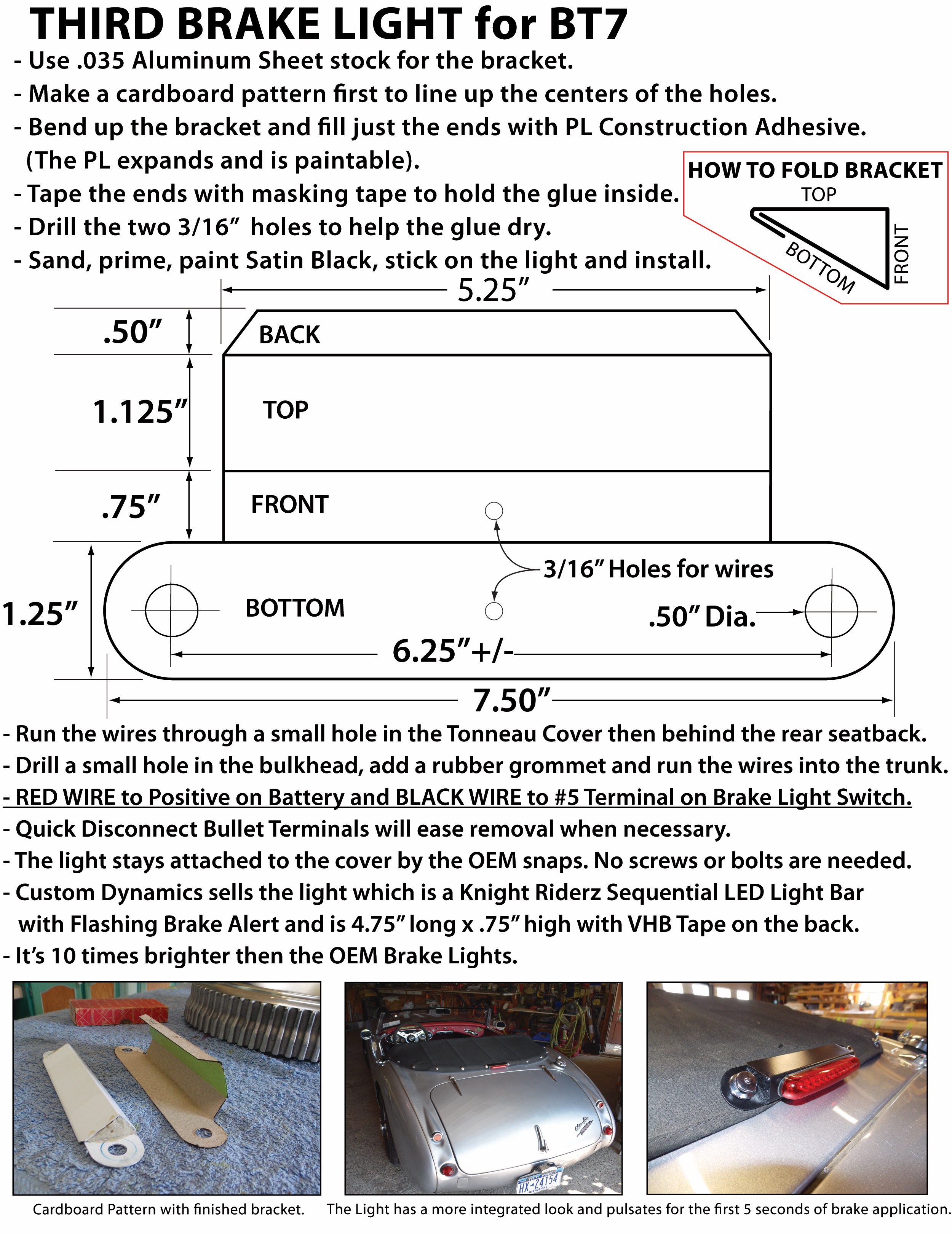

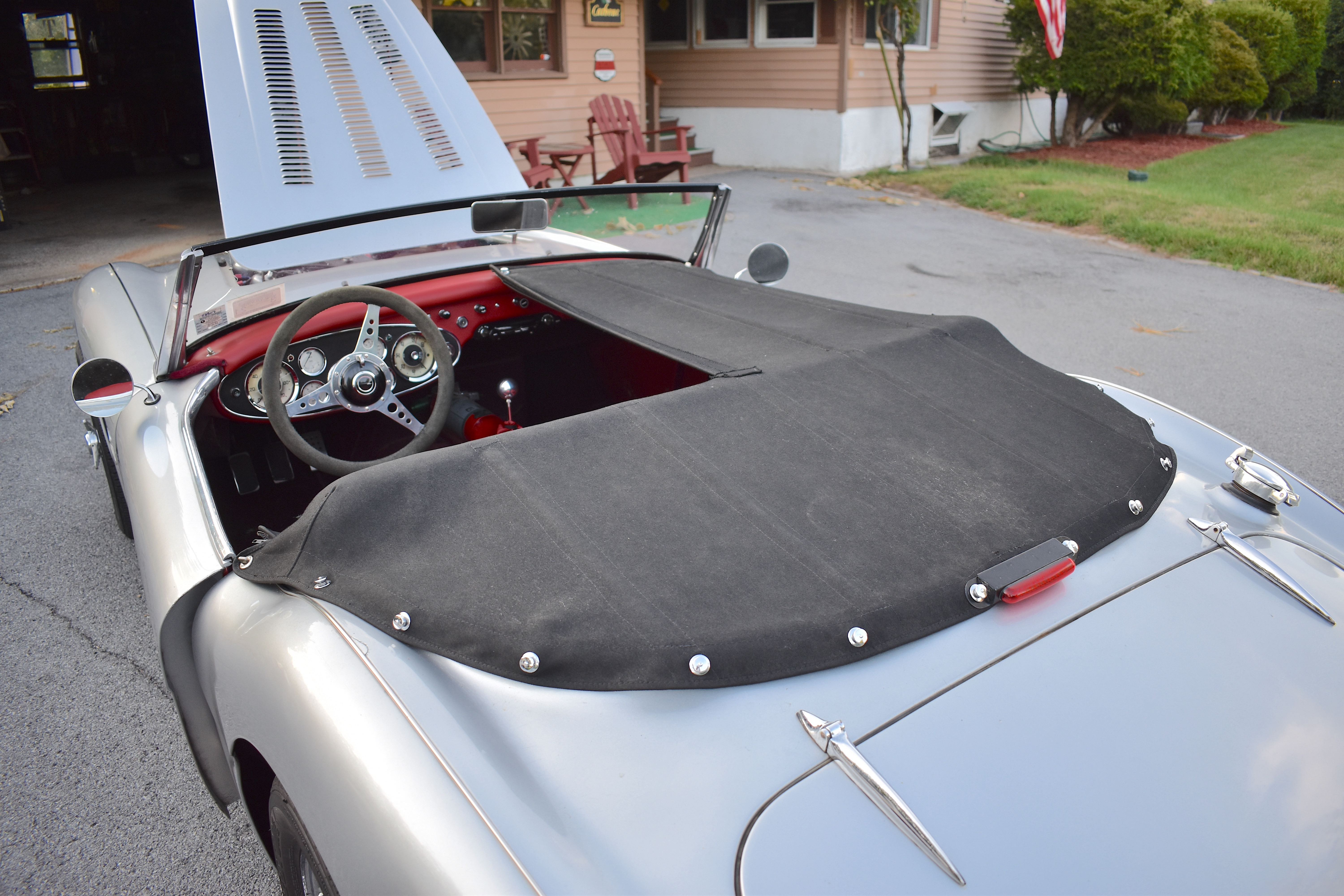

Hi Guys,
I can't be the first one to bring up this topic and I know there are lights available on the internet. I like to think my idea is better because
it's more integrated into the style of the car; it looks like it belongs there.
This light is held on by the TENAX fasteners along the edge of the tonneau and the convertible top, and it is removable and interchangeable. It flashes for 5 seconds after initial brake application.

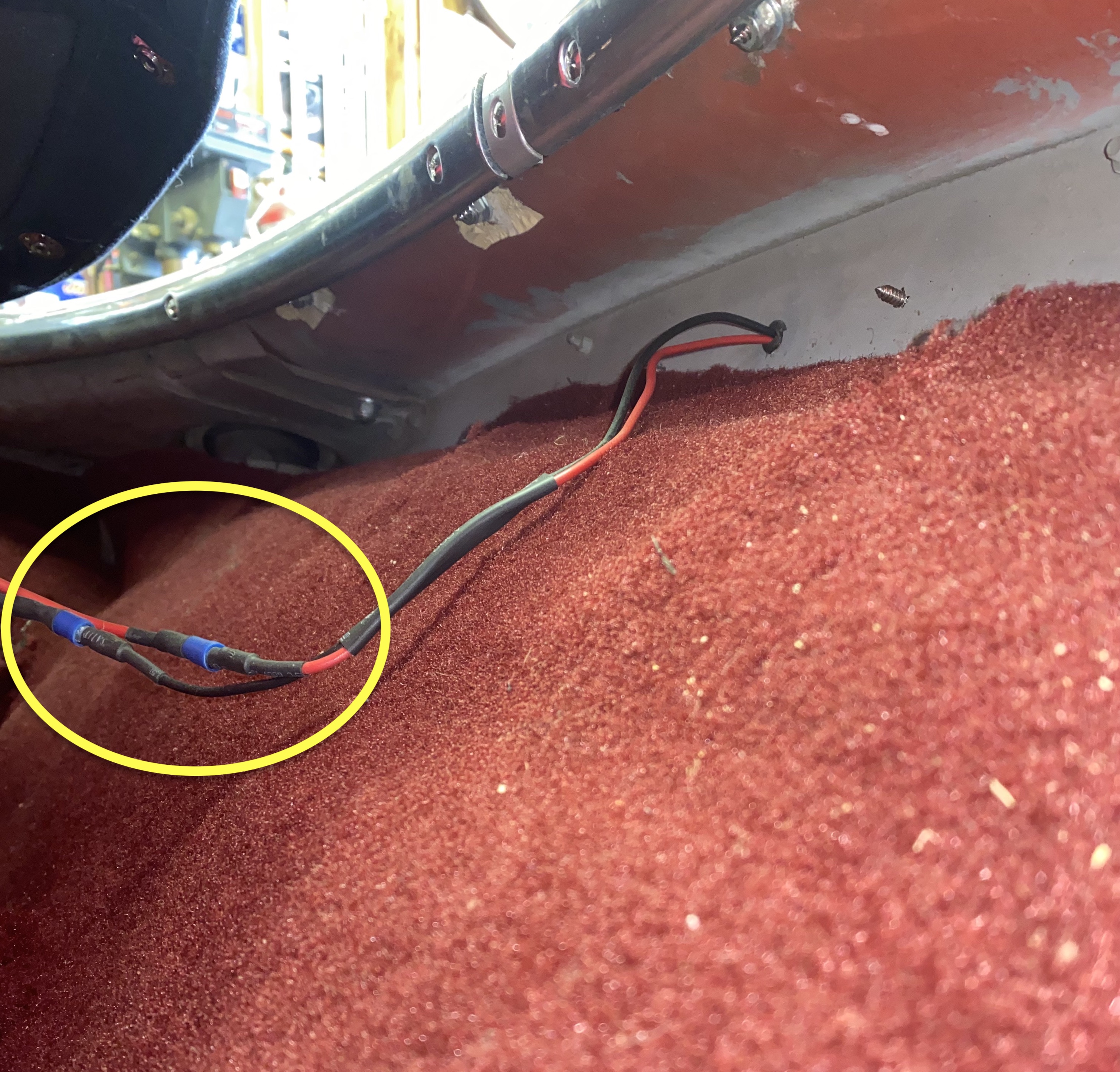

You can switch it from top to top by using bullet connectors.
Buona Fortuna,
Peter C.
