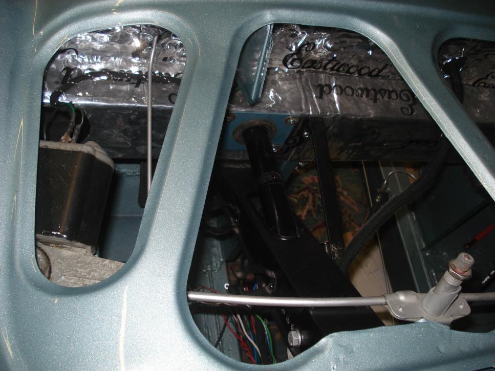

I used the Eastwood (dynamat extreme equivalent) sound deaden-er. Of course it went on before anything else was there. If all the cables and wiring is already in place, it would be difficult as this stuff sticks very quickly. I do not get any hint of engine bay heat in the car. I covered the lower portion with some matching blue vinyl as the interior so the silver would not be visible, the rest gets covered by carpeting.

I did mine a day or two ago with Dynamat. It wasn't such a pain. I used the existing tarred cardboard liners that were there (had to make a couple of cuts to separate it from the fire wall due to existing cabling). Then I used them as templates. They hadnt stuck well to the firewall and were too hard to pull off intact. If you keep the sections of the dynamat down to a 12" max size, then its not to difficult to get it up to the firewall without tangling up. I have half of the dash out though - just the wood section with the instruments still in place.
I have used a insulation material very similar to Dynamat (easy to find in Italy), glued it on the firewall, and then I have glued UP the original tar paper,
easy to cut the necessary holes and better insulation capacity, original appearance if someone put his head under the dash
Cheers
When doing this, it's helpful to shine a work light inside the engine compartment. Once you're under the dash, the light will shine hrough the open areas that you might have missed. Some rope caulk ("dum dum") will help fill in those areas with odd configurations. Pay attention to where the wires come through the grommets as well. Any open space can let in a lot of hot air.
