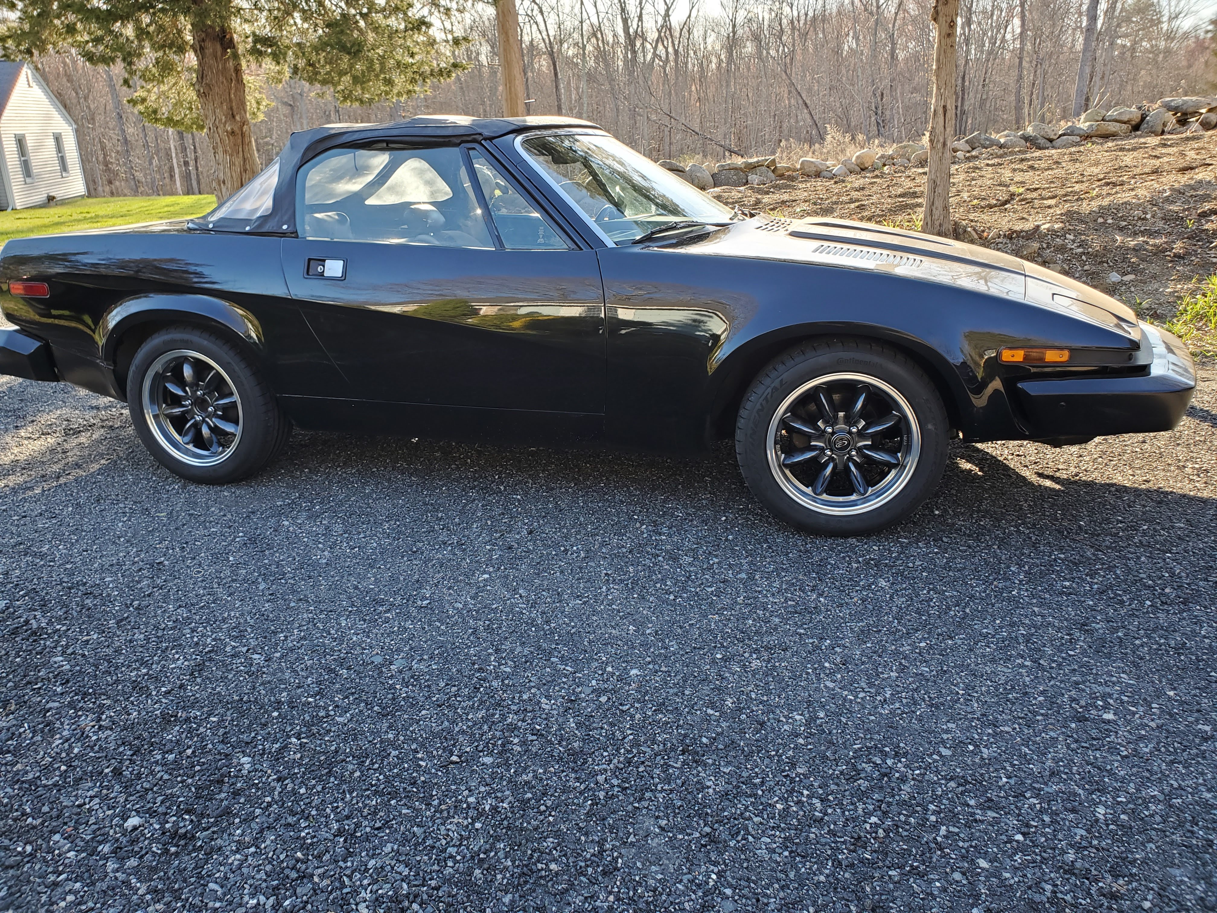

Just got new Rota 15X7's on it today and went for a spin. It may not be faster but I believe it's smoother! I've done a bunch of suspension work including lowering springs, shocks, steering components and needle bearing steering kit. Replaced a set of Weber downdraft carbs with rebuilt OE Strombergs, sorted the electrics, installed new brake cylinders in the rear along with braided brake lines. Just need to sort out the rattly doors and an overflowing carb (float setting probably). Still staying close to home with our outings but looking forward to voyaging further afield this summer.
Nice job. Your description of work done sounds familiar - pretty much the same things have been done on ours. I'm ahead of you on the doors though -- the window track rubbers are replaced plus one of the regulators. You're ready to go just in time for the good weather!

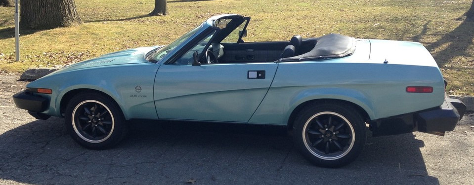

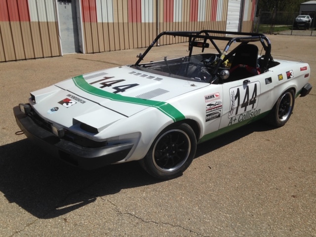

I always loved my wedge it has ben in the family since 89 It has under gone a few mods....... going to Road America in May (WRL)

Your Wedge looks heavily modded! Cool!
The Wedge Shop is local to me and I know Woody from 30 years ago. I'm headed there today to pick up a used part he has for me.

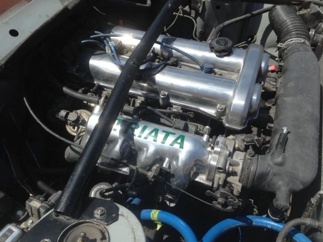

To say the least... IRS rear suspension from 1.8 Miata and much much more. Have just fitted up the castor kit
Woody sells. The race track will tell the tail on that bit. Pic of the twin cam 1.9 L.

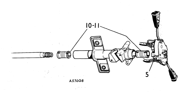

the moaning and groings seem to be coming from in side the cotpit. Top steering column. Looked once when I had the dash out for a bush to lube up but nothing.
There are bushings at the top and bottom of the steering column - 10 and 11 in this diagram - maybe they are shot.
