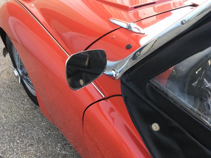

David. I have one that looks very much like the photo Healey Rick supplied.
fixes right to the stansion. Extremely helpful!

I bought one at Carlisle. I like it so much I am eliminating the fender mounted one in my restoration. Only thing to consider they are not side screen friendly. You need to carry an Allen wrench to remove them if needed.

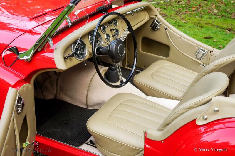

I've never like fender mounted mirrors, so I searched for alternatives and found something similar to the Bugeye part. My 1957 TR3 has the Dzus-style stanchion attachment to the scuttle. I removed the windshield as well as the rearmost Dzus on the driver's side. I then removed the stanchion plate and removed the wire on the back side, which the Dzus fitting would have locked to. Using the stanchion plate as a guide, I drilled a 1/4 inch pilot hole in the inner plate (through the slot in the scuttle), then reamed that hole to 3/4 inch diameter in order to pass through a bolt.
I had previously located a vintage Wingard mirror on eBay (era appropriate), which is threaded at the base for a 5/16 x 24 x 1 bolt. I reattached the stanchion plate to the scuttle and mounted the windshield, locking it in place with the three remaining Dzus-fittings. Feeding the stainless bolt through with washer and lock washer, I place another stainless washer in the empty recess where the Dzus would have been (it fit!), I then placed a thin, rubber washer (which was trimmed to the diameter of the mirror's stem base) over the bolt, and threaded the bolt into the base of the stem. I used a socket driver to tighten the bolt to the stem once the mirror was correctly positioned. I then adjusted the mirror while sitting in the car.
The first photo shows a TR2 where the idea came from, the second and third photos show the installation on my car. It looks like it was a factory-fit.

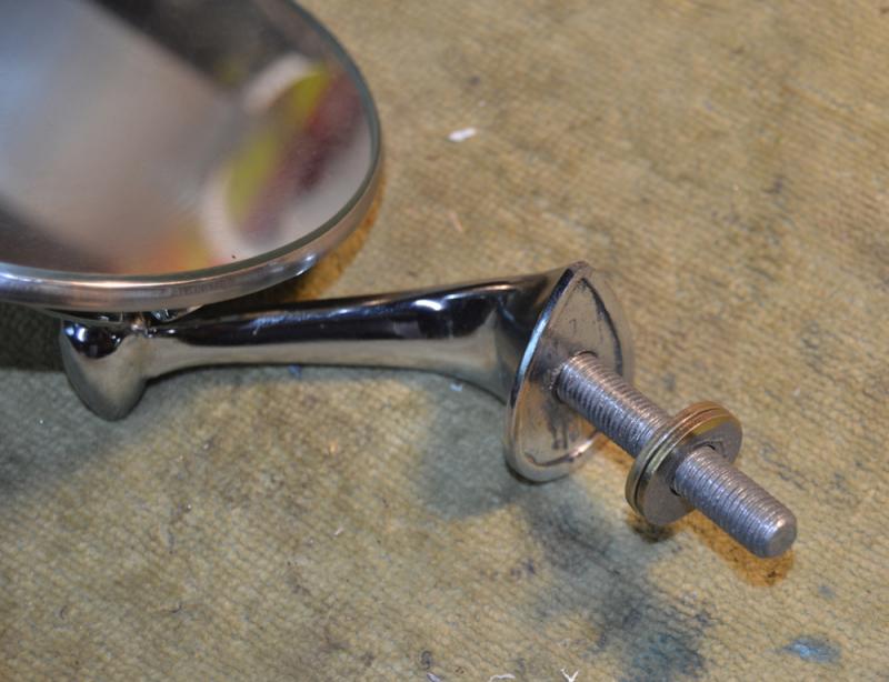

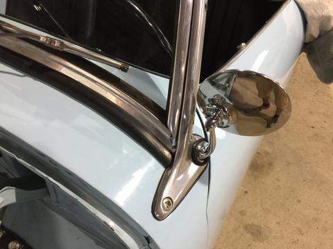

I tried a couple of different mirrors, including the Harley-Davidson type, but I wound up modifying one of the regular fender mirrors. For the driver's side, you need the passenger side wing mirror. There's a stud on the bottom that has the correct threads, but it is too short. The stud is cast in, so I cut it off and drilled and tapped for a longer stud. A couple of washers to fill in the recess in the stanchion, and it screws right in.

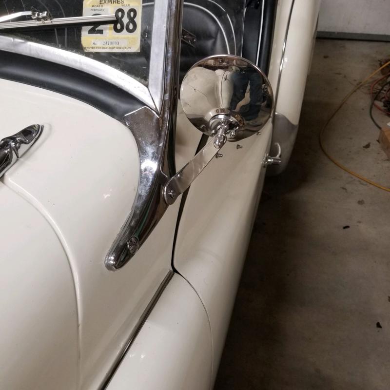

I have bent up some thicker Stainless steel to see how it will function. My last effort was a bit too thin so the mirror vibrated.
That is probably as good as anything David, as you are never likely to take it off maybe drill a small hole and tape a screw into the stanchion just to stop it rotating down. I think you are onto a winner with that one, well done.

Thank you. I had the Stainless steel laying around at home.
I put washers under the bracket to fill in the counter bore so the bracket is clamped down very tightly. The socket head screw allows a good amount or torque on the screw .
