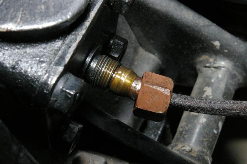

Make sure to install the olive in the correct direction as well. Cheers, Mike
I wondered about that. It was very difficult to tell if there was a larger and smaller side to the olive? Maybe a Repro that was n't made right? Leaks? Also.... Is the control head supposed to turn with wheel?
Here is a picture of the WRONG way to install the olive. Cheers, Mike
